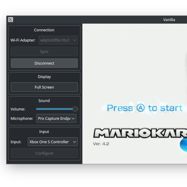

Although Nintendo is mostly famous for making great games, they also have an infamous reputation for being highly litigious not only for reasonable qualms like outright piracy of their games, but additionally for more gray areas like homebrew development on their platforms or posting gameplay videos online. With that sort of reputation it’s not surprising that they don’t release open-source drivers for their platforms, especially those like the Wii U with unique controllers that are difficult to emulate. This Wii U gamepad emulator seeks to bridge that gap.
The major issue with the Wii U compared to other Nintendo platforms like the SNES or GameCube is that the controller looks like a standalone console and behaves similarly as well, with its own built-in screen. Buying replacement controllers for this unusual device isn’t straightforward either; outside of Japan Nintendo did not offer an easy path for consumers to buy controllers. This software suite, called Vanilla, aims to allow other non-Nintendo hardware to bridge this gap, bringing in support for things like the Steam Deck, the Nintendo Switch, various Linux devices, or Android smartphones which all have the touch screens required for Wii U controllers. The only other hardware requirement is that the device must support 802.11n 5 GHz Wi-Fi.

  1. I was under the impression that yhe Wii U pad used a proprietary wireless connection. But perhaps this project is sending the data stream over the wired LAN connection?
    This post could have used more tech details.
    1. I am stunned this was the only obfuscation Nintendo did:
      The PTK (pairwise transient key), derived from the PSK (Wi-Fi password) during the WPA handshake is rotated 3 bytes to the left.
        1. You mean helpful, very. Is there a reason they should have done anything else?
          Because if they had implemented anything real this and related projects would be under legal threat.
