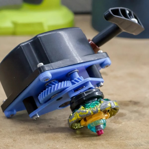

[Jon]’s project started with some of the early metal Beyblades, which are traditionally launched with a small geared ripcord device. He soon realized he could up the action by doing one simple thing—spinning the tops far faster than the manufacturer ever intended. More rotational speed equals more kinetic energy equals more legal liability fun, or so the equation goes.
The design for [Jon’s] “WMD Launcher” is straightforward enough—he combined a lawnmower pull starter with a 12:1 geartrain to turn the Beyblades at truly ludicrous speeds. It’s basic engineering — a couple of 3D-printed gears do the job — but the results are hilarious. The tops begin to emit loud noises as they turn in combat, and some move so fast and erratically that they won’t even stay inside the arena. Protective eyewear is virtually mandatory. Files are on Printables for those eager to build one at home.

  1. I’m wondering if the intermediate shaft is even necessary, assuming you made a ring gear with internal teeth * you might be able to fit the whole thing inside the plate too.
    At that point it’s purely a flat surface with 2 bearings as well, greatly simplifying the structure.
    *To preserve the direction of rotation
