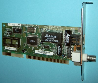

One of the aspects that I somewhat overlooked whilst scrounging through my junk bin was just how much faster internet connections have become compared to the early 2000s. My cable internet connection of the time was hooked up to a DOCSIS 1.x-based modem, with 40 Mbit/s as the theoretical maximum downstream capacity.
For this a 100 Mbps PCI or ISA NIC was plenty. Back then I was using NE2000-compatible 10 Mbit ISA cards and enjoying the ISA ‘Plug-and-Pray’ life to my utter dismay while configuring IRQs and other relevant settings. At least this taught me about legacy connectors like those for coax-based thick- and thinnet as well as AUI, I guess.

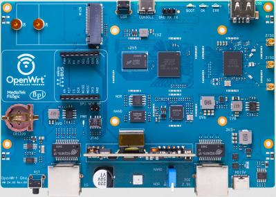

Beyond these options you also have various dedicated router boards, with the OpenWrt One and Banana Pi BPI-R4 being two viable options here. Expect to shell out at least $100 just for the bare board, sometimes even before adding an enclosure and other essentials. Here you’re basically buying a typical off-the-shelf router and doing the final assembly yourself.
The final result would be fairly similar to the OpenWrt-based Xiaomi router that I’m currently using. This fancily named Mi AIoT Router AX3600 is like many Xiaomi routers and other networking devices officially supported by OpenWrt. These thus make for another viable target to reflash with a clean OpenWrt image and no OEM customizations if that’s the one thing that irks you about these commercial offerings.
Clearly there are a lot of options here, hardware-wise, even if on the ARM side of things you’re probably just better off buying that existing OpenWrt-supported router as the most economical option, unless you happen to have a Raspberry Pi 4 SBC or equivalent gathering dust.

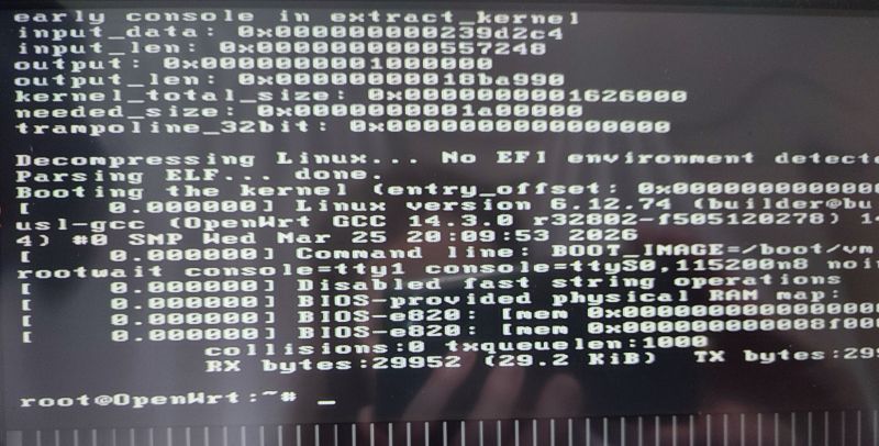

After taking the same SD card that failed to work before and slotting it into this 2012-era system, it booted into OpenWrt, terrible graphics courtesy of the VGA-to-HDMI adapter and stray reflections included:

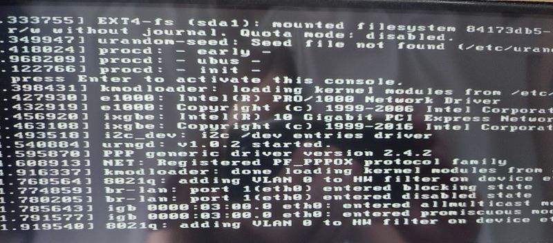

After this momentous step I proceeded to triumphantly check for a network connection on the connected laptop, but saw that it didn’t even see an active network connection. That’s when I noticed the inactive link and activity LEDs on both of the D2500CC mainboard’s Ethernet jacks, which was rather worrisome.
I did have a poke at ifconfig to confirm that it had detected both onboard NICs and created connections for them, with indeed both an eth0 and eth1 interface created in addition to the loopback. Slightly baffled I did try to prod DHCP just in case, but at this point the console began to corrupt itself:
Although I’m pretty sure that I didn’t miss any steps, something is still clearly amiss. Whether it’s a hardware issue with the mainboard, some BIOS configuration glitch, an issue with the OpenWrt image, USB being USB or a quaint planetary alignment, I obviously wouldn’t be able to log into the graphical administration interface any time soon at this rate.
This mostly leaves me with more debugging to do, as well as the increasingly dismayed feeling that some things really were easier in the past.
