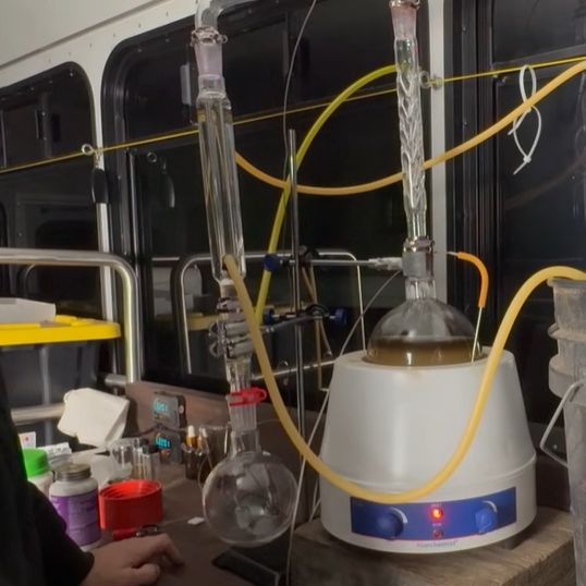

Distilling Stale Gasoline To Make It Usable Again
Pouring the resulting distillate for testing. (Credit: Lowered Expectations, YouTube)
The propensity of gasoline to ‘go stale’ through the process of oxidation is the reason why gasoline that has been stored for a long period of time is considered to be unusable, as it will no longer combust property. Since this process creates the sludge that you find in the bottom of an old gasoline canister, it follows that you may be able to distill out the still good gasoline. With this reasoning, [Joel] over at the [Lowered Expectations] channel set to work to try out this theory.
As part of his job of maintaining things like pressure washers, he got access to many grades of stale gasoline to experiment with. After a short demonstration of how poorly these grades of stale gasoline burn it’s on to the main distillation event. To the stale gasoline aluminium oxide is added as both a catalyst and to create nucleation sites that will prevent ‘bumping’ where you suddenly get a surge out of the heated flask.
Of course, that this is incredibly dangerous should be obvious, and the lack of PPE on the side of [Joel] is somewhat worrying. On the positive side, he does take it easy with ramping up the temperature on the gasoline to try and find the sweet spot where production seems sufficient. This turned out to start at 70°C in the flask when the condenser began to receive its first load of presumably clean-ish gasoline.
The goal here is of course to approximate the function of the fractionating column (‘distillation tower’) at refineries at smaller scale, which [Joel] appears to be doing correctly with what looks to be a Vigreaux column. Since the base product is gasoline with oxidized contaminants this process is of course quite different, so he goes through the different temperature ranges to see what kind of distillate he gets, up to nearly 200°C before calling it.
Ultimately 880 mL of the initial 1 L was collected, with the various distillates combined for testing. Unfortunately none of the testing is actually covered in the video, but it is mentioned at the end that a second batch of the distillate was used to power his car, so presumably it works.
Suffice it to say that ‘works’ doesn’t mean that it is safe, of course. Heating such stale gasoline produces many highly flammable and combustible substances, along with many that are just downright bad for your health to be exposed to. The plethora of very short-term to all the way to very long-term health effects this may cause should be obvious.

  1. up to nearly 200°C
    maybe a good idea from a safety standpoint, but you’re definitely not distilling out all the viable parts of the original gasoline at that temperature.
  2. My experience is that several years old non-ethanol gas burns just fine. You just make sure it doesn’t stay in the carburetor to dry out and leave sludge. I let the engines run till they’re empty before letting them sit for an extended period. The containers I leave the gas in are those newer unvented types that swell up like overripe fruit when they get warm. I figure that keeps most of the more volatile molecules in the mix. I don’t use any of the stabilizers either. YMMV.
    1. I mixed in some stale gasoline to new at a 1:4 ratio to get rid of it, but it was clear. I certainly wouldn’t do it with some of what was in the video which was a murky black similar to beer.
    2. The lack of ethanol isn’t what’s saving you; your containers must just seal better and your carbs must be more forgiving. I’ve used ethanol free in various things, but unfortunately even running the carb dry every time often isn’t good enough, it still clogs eventually. Maybe removing the bowl and blowing it clean with compressed air after every time would be enough, but that’s silly. I’ve had gas go bad in the tanks of cars too, probably again because they weren’t fully sealed. The only difference with ethanol is, when oxygen gets into regular gas you might get sludge and you definitely lose volatiles (which can mess with your octane number). But when water gets into ethanol gas then if there’s not enough alcohol it can separate, so you’ll have to add even more alcohol (heet or high-percentage bathroom isopropanol) to reabsorb it. I consider that easier to deal with, and it also makes up for some octane loss as long as the afr doesn’t become problematic.
  3. While you can “clean” the fuel by removing sludge and heavy contaminants, the distillation process does not regenerate the volatile “light ends” that evaporated when the gas went bad. The resulting distillate often still struggles to combust properly in an engine.
    In any case, reducing process temperature by employing a vacuum distillation apparatus seems like a good safety measure.

    1. Modern ethanol and other bio based “gasoline”? 2 or 3 months especially here in the EU. After that it’s basically a cleaning product and not a fuel. You can then use it in a parts cleaner, if it still burns then you can light a campfire with it.
      Actual properly made gasoline? I got some that’s probably 15 years old. I’ll let you know if I ever find out how long it can last. I can probably store it for another 50 years as long as it doesn’t evaporate.
        1. The mandatory 5-10% additive can be anything from acetone to isopropanol and other stuff. It’s not pure ethanol, it’s whatever they can scrape up on the cheap to meet the regulation.
    2. I buy petrol for my lawnmower once every couple of years. It runs just as well on the dregs of the previous purchase as it does on the new stuff. It doesn’t seem to deteriorate at all. This is regular unleaded in the UK. YMMV.
  5. What happens to the anti knocking agents (that prevent damage to the engine over time), I am guessing that they remain in the distillation side.
  6. I’ve seen claims that old gasoline can be used to thin used (filtered) motor oil for use as diesel fuel. I have yet to try it myself.
  7. If you have the option you can partly prevent it. You do need a large separatory funnel. You throw new gasoline in there, as much as fits. You add water and mix it in the gasoline. You then let it sit for a while and the water sinks to the bottom. You then drain the water. The water collects all the ethanol, purifying the new gasoline a bit, making it last longer and makes your engine happier, makes it consume less fuel, provide more power and makes your vehicle last a lot longer.
    1. Lowering the octane by deliberately adding water that you then contaminate, while also removing anything else that has a small nonzero solubility in water, and also leaving behind a small nonzero amount of water in the part that doesn’t separate either initially or ever. If you’d like to have to add an octane booster later, why not add a stabilizer now?
