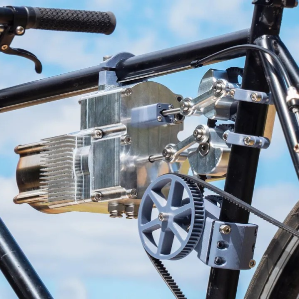

A photo of a Stirling Engine attached to a bike
Over on his YouTube channel [Tom Stanton] shows us how to build a Stirling Engine for a bike.
A Stirling Engine is a heat engine, powered by the expansion and contraction of a working fluid (such as air) which is heated and cooled in a cycle. In the video [Tom] begins by demonstrating the Stirling Engine with some model engines and explains the role of the displacer piston. His target power output for his bike engine is 150 watts (about 0.2 horsepower) which is enough power to cycle at about 15 mph (about 24 km/h). After considering a CPU heatsink as the cooling system he decided on water cooling instead.
[Tom] goes on to 3D print and machine various parts for his bike engine. He uses myriad materials including aluminum and Teflon. He isn’t yet comfortable machining steel, so he had the steel part he needed for handling the hot end of the engine manufactured by a third party.
[Tom] explains that when he started the project he had intended to make a steam engine. But after some preliminary research he discovered that a Stirling Engine was a better choice, particularly they are quieter, more efficient, and safer. After a number of false starts and various adjustments he manages to get his engine to run, which is pretty awesome. Standby for part two to see the bike in action!

    Also- I can’t fathom how this works. Stirling engines function on a heat differential. I skimmed the video and cannot see where that heat differential is generated. In models a candle or alcohol burner supplies the “hot end” and this write up says it’s water cooled (??).
    Stirling powered watercraft I’ve seen written up were heat-fired. Even the coffee cup varieties use the heat from the coffee.
    There is not much I can imagine that carrying around a cryo cooler or something is remotely close to providing useful work.

    1. The project is not completed. He mentions towards the end he still needs to build “a proper burner” for it.
      The hot end is the thick steel cover over the cylinder. He does a couple demonstrations where he loads up the cover with heat from a torch and it continues running for a couple minutes after he removes the torch.
      Around 10m mark – https://youtu.be/zB3lrLjqIh4?si=0w6XXvWJ6kR7u54W&t=607
      Around 15m mark – https://youtu.be/zB3lrLjqIh4?si=ADQV1votXA20ORY0&t=921
    2. Skipping to the last minute or so of the video, he’s test-firing it by hitting it with a propane torch, and then mentions “I also still need to build a proper burner”.
      It also doesn’t actually spin the bike wheel in this video other than a few weak turns on a test stand, so it’s very much a work in progress.

      1. I had assumed that he wanted the rear wheel to act as a flywheel. Of course, he later added a discrete flywheel as part of his experiments, so…

  3. I’m sorry but I’m going to be a real partypooper here. I relly dislike negative commenting, but I HAD need to think twice before posting whatever youtube suggest they watch.
    This is completely bogus/futile. I’ve built several Stirling engines in my days. To get any useful power out of them you need to enclose the whole engine in a gas tight shell, and pressurize that (usually with helium at about 10 bar). Just making a Sirling engine run RELIABLE and CONTINIUOSLY is hard. Real hard. Making it produce useful output power is even harder. It requires precision machining and very careful selection of materials. This is NOT something you will be able to 3D print out of plastic. I’m sorry, but this guy will not be able to produce a Stirling powered bicycle. Maaaybe ad money for himself if people keep clicking these kind of videos…
    If one wants to build a Stirling engine I’d suggest starting with a model and just work on that until it runs every time it’s started, until the fuel runs out. Then, evaluate that project and perhaps take the idea further.
    Also, a Stirling engine should have a regenerator to be called “Stirling engine”. There are many kinds of “hot air engines”…
    1. Pretty much this. For all that I’ve learned of Stirlings, you need the working fluid (gas) to be pressurized in order to increase the pressure swing and carry more heat, therefore generate more power. At atmospheric pressures, the engine would turn out absolutely massive for any appreciable amount of power.
      With the gas inside the engine being pressurized, the gas outside needs to be pressurized too or the piston would just get stuck at one end – hence the gas tight shell. Some designs try to use springs for the same point, but with millions and millions of load cycles at very high stress levels they tend to fatigue and break. However, this limitation only applies to single piston Stirling engines.
