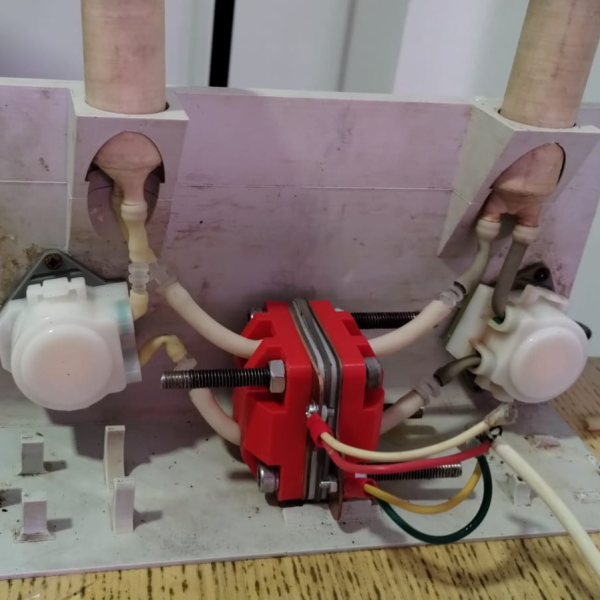

A red, cuboid electrochemical cell is in the center of the picture, with a few wires protruding from the front. Tubes run from each side of the cell to a peristaltic pump and tank on each side. The frame holding the pumps and tanks is white 3D printed plastic.
The flow battery is one of the more interesting ideas for grid energy storage – after all, how many batteries combine electron current with fluid current? If you’re interested in trying your hand at building one of these, the scientists behind the Flow Battery Research Collective just released the design and build instructions for a small zinc-iodide flow battery.
The battery consists of a central electrochemical cell, divided into two separated halves, with a reservoir and peristaltic pump on each side to push electrolyte through the cell. The cell uses brass-backed grafoil (compressed graphite sheets) as the current collectors, graphite felt as porous electrodes, and matte photo paper as the separator membrane between the electrolyte chambers. The cell frame itself and the reservoir tanks are 3D printed out of polypropylene for increased chemical resistance, while the supporting frame for the rest of the cell can be printed from any rigid filament.
The cell uses an open source potentiostat to control charge and discharge cycles, and an Arduino to control the peristaltic pumps. The electrolyte itself uses zinc chloride and potassium iodide as the main ingredients. During charge, zinc deposits on the cathode, while iodine and polyhalogen ions form in the anode compartment. During discharge, zinc redissolves in what is now the anode compartment, while the iodine and polyhalogen ions are reduced back to iodides and chlorides. Considering the stains that iodide ions can leave, the researchers do advise testing the cell for leaks with distilled water before filling it with electrolyte.

  1. For people who haven’t done so before, really leak test any 3d prints designed to store liquids. Especially liquids that aren’t water. 3d prints often aren’t water right. There are tricks to make them water right, like adding wax and whatever else.
    Cool project. The potentiostat itself is an accomplishment. Wish someone sold the boards near cost.
    1. Which is why they explicitly state those parts need to be printed with 100% infill and 5 perimeters and then leak tested, I suppose.
          1. This is exactly what I do for my hydroponics (using ASA). Great success so far — nice, glossy finish and no leaks.
    2. I am one of the creators of the project. We use polypropylene for the flow frames, which is one of the few 3D printed plastics that is relatively easy to make water tight if printed at 100% infill with high perimeters and some overflow.
    3. Instead of 100% infill, maybe it’d be better to print so there is a continuous void that is then filled with wax.
    4. This is a HazMat response just waiting to happen. Corrosive chemicals handled by amateurs going into things they 3D printed.
      1. The volumes are very low (10mL total) with this kit and the materials in contact with the chemicals were selected to be chemically compatible with a wide range of active material choices (polypropylene, grafoil, etc). With that said, care should be taken whenever handling reactive chemical substances. Always read the msds of materials and wear the proper ppe. As with any activity, accidents can definitely happen if people are careless.
        1. Its not you I am worried about. You are not Amateurs however there are lots that will try to repeat your work thst are amateurs and will make a mess of it. And they will do it not in a lab but in their home.
          1. We try to provide instructions that try to inform people well about the potential risks of doing this, but obviously it is up to anyone who wants to reproduce this to ensure their own safety. We do not advocate for anyone to reproduce this in an unsafe environment or under unsafe conditions. Thanks for your concern!

  3. I could not find any info on what this cell can do.
    How much electrical power can this cell consume/provide? What capacity does this liquid provide (Wh/liter)? What does a typical system cost?
    I suspect this is like a Farnsworth-Hirsch fusor (yay fusion, science fair) versus a Tokamak fusion reactor (making energy). I guess this design is more like an educational tool, rather than a suitable DIY method for building a few and storing a 10kW excess photovoltaic generation.
    I don’t want to bad-mouth this. Even an educational open design of such a complex design is a great achievement.
    1. This is an educational tool. It is meant to provide a tool for reproducible research of chemistries or education about the basics of flow battery systems. With the chemistry we tested the system stores around 250mWh of energy. This isnt even enough energy to run its pumps and arduino, but a meaningful scale to validate chemistries and materials. About cost, the cost of materials is around 500 EUR, including the potentiostat and pumps. It is definitely feasible to diy, we already have a few people successfully and indepedently reproducing the kit.
      We are working on the first open source large scale stackable design to achieve the kWh scale and enable people who want to do developments on the engineering side. This will enable people to DIY larger scale systems – at their own risk – but ideally it would enable companies to produce ready-to-use retail systems at low cost.
