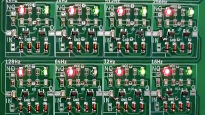

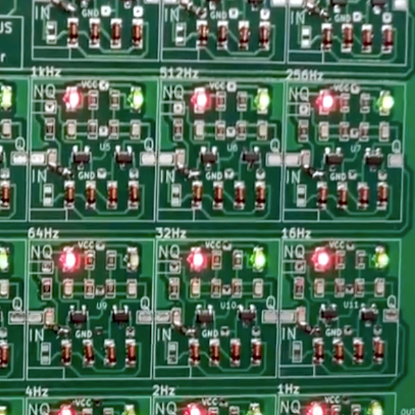

Most of us know that a quartz clock uses a higher frequency crystal oscillator and a chain of divider circuits to generate a 1 Hz pulse train. It’s usual to have a 32.768 kHz crystal and a 15-stage divider chain, which in turn normally sits inside an integrated circuit. Not so for [Bobricius], who’s created just such a divider chain using discrete components.
The circuit of a transistor divider is simple enough, and he’s simply replicated it fifteen times in surface mount parts on a PCB with an oscillator forming the remaining square in a 4 by 4 grid. In the video below the break we can see him measuring the frequency at each point, down to the final second. It’s used as the timing generator for an all transistor clock, and as we can see it continues that trend. Below the break is a video showing all the frequencies in the chain.

  2. Hm. Not even a schematic of the ÷2 circuit. I was curious about how he did this with just two transistors and some diodes.

      2. Wasteful use of components.
        I have Tektronix instruments where divide by N (N=2 or 5 or 10) is done with 2 transistors, 2 diodes, 2 capacitors, 5 resistors.
        FFI, see the Tek184 schematic.
          1. I should note the 184 only used N=2,5,10, but the same circuit could divide by any integer up to, say, 16.
            Basic technique: each input pulse dumps a glug of charge onto a capacitor, thus raising the voltage. After sufficient glugs the voltage exceeds a threshold, the charge is drained from the capacitor and causes a pulse to the next stage.
            Increasing a resistor reduced the size of the glug and increased the division ratio.
            Skill plus imagination enables possibilities that brute force cannot achieve.
