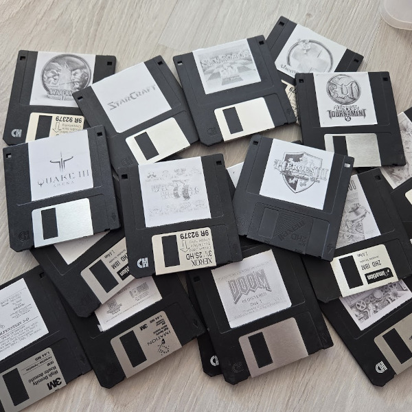

The PC itself is a modern build with an up-to-date operating system, but hidden in a 386-era case with early-90s styling. The real gem of this build though is the floppy disk drive, which looks unaltered on the surface. But its core functionality has been removed and in its place an Arduino sits, looking for NFC devices. The floppy disks similarly had NFC tags installed so that when they interact with the Arduino, it can send a command to the computer to launch a corresponding game. To the user it looks as though the game loads from a floppy disk, much like it would have in the 90s albeit with much more speed and much less noise.

The floppies are not modified, they just have an NFC sticker on them. The drive is what they modified. It should be possible to fit an NFC reader in the drive while still keeping it functional though.
Doing both would be sweet. The NFC tags only have a few kB but that would be nice for a run command and a readme.
Or.. what about putting some sort of ID on the floppy disc and then read them wirelessly with the arduino when it goes into the slot? Total cost would only be less than 5$ for the reader and 2$ for a roll of the reprogrammable id stickers. Oh wait.. that’s nfc.
