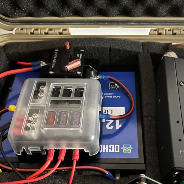

Although ham radio offers a wide array of bands to transmit on, not to mention plenty of modes to communicate with, not everyone wants or needs to use all of this capability. For those needing simple two-way communication services like FRS or GMRS are available (in North America) with much less stringent licensing requirements, and GMRS even allows repeaters to be used to extend their range beyond the typical mile or so. [Dave] aka [N8DAV] has built an off-grid simplex repeater that can travel around with him wherever he goes.
The repeater itself is based on a pre-built simplex repeater module, which means that it has to record an incoming signal and then play it back on the same frequency. Compared to a split frequency repeater which uses different frequencies for transmit and receive this can be a bit cumbersome but simplifies the design and the use. A Baofeng UV-5R is used to perform the actual radio duties paired to a 40 watt amplifier to extend the range as much as possible. It’s all packed into a Pelican-like case and set up with a large battery that could power it for a number of days, making it useful for camping, rescue, or other off-grid activities.
For those wondering why [Dave] is using his ham call sign instead of his GMRS one, all of the equipment in this build will work in either the UHF ham bands or the channels reserved for GMRS with minor adjustments, so it’s perfectly possible to use the setup for one’s preferred license. And, for those in other parts of the world without GMRS there’s a similar class of radio called UHF CB which might be able to support similar builds, but be sure to check your local jurisdiction’s laws before hooking something like this up. For an even longer-range radio repeater using similar equipment we’d recommend looking to the skies.

      1. 40W on GMRS may be perfectly legal in the US, but I can guarantee you the spurs coming out of the Baofeng amplified aren’t. Many Baofengs are in violation of FCC rules out-of-the-box, with no amplification. This project needs a tight filter or tuned circuit between the Baofeng and the amp.
        1. noob here – i had the impression that most amps function implicitly as a bit of a filter all on their own? like, specifically, i thought driving harmonic frequencies was usually the result of a flaw in the amp?
          i glanced at the youtube and it’s a baofengtech amp, specifically designed for this purpose. so worse than spurious sidebands: it’s not a hack! but you can look up the amp, it’s been characterized a little bit already. it’s apparently a consumer product designed to meet the requirements, and not some general purpose tool released with just a prayer that you won’t point it at your feet. i have no idea if that’s good or not.
          1. Yes, most amps have filters. They don’t solve the problem if the spurious signals are too strong however, particularly if they are within the same band, they may be amplified as is.
            The amp only knows you’re trying to send a signal within a given frequency range and will amplify things in that range, they don’t know your trying to transmit on frequency X.Y and filter everything outside of the intended bandwidth.
            This is also why adding an amp with poor equipment can be a violation in itself.
          2. You feed an amp garbage, all it can do is amplify that garbage. What you get is garbage that causes adjacent and/or harmonic interference. I would warn that every Baofeng I have put on the ‘scope is crap on 2m, so much so I NEVER use them on 2m, and am not buying Baofeng unless it passes harmonic & spurious emissions testing on all bands that require those tests. After 3 years of testing every Baofeng multiband HT I put on my scope fails on 2m, so I ONLY ever use them on 440. I try to sell what I have, no one wants them.
        2. Well, I’ve seen lots of hate for the Baofengs and I do own a few, so I checked and then had a friend check (we are both measurement nuts so we own plenty of RF test gear between us), all I can say is that his and mine would be legal if we were subject to the FCC regulations (fortunately we don’t live in the land of the free so aren’t subject to their regulations)
          If they’d be FCC legal after I’d stuck a ~9dB gain block on them, I’m not sure, I don’t have the test results to hand to do the maths and don’t actually own a suitable amplifer so it would just have to be an exercise on a calculator but I am now curious.
          I think the main problem, which I missed entirely and someone else pointed out, is that they’re not type approved for GMRS use so are defacto illegal to use on those channels with or without an amplifier.
        3. Any radio that can transmit on any frequency other than GMRS (or FRS) channels is illegal on GMRS. Please read the regulations. Licensed hams, however, can use any radio they like on any allowed ham frequency commensurate with their license class privileges, provided it meets the technical requirements. That is because hams have passed a test to access their knowledge of the regulations and their competency not to mess up.
