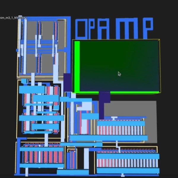

Our hacker [Pat Deegan] of Psychogenic Technologies shows us the entire process of designing an analog ASIC. An ASIC is of course an Application-Specific Integrated Circuit, which is basically just custom hardware. That’s right, “just” custom hardware.
Services such as those from Tiny Tapeout make it possible to get your hardware designs built. And tools such as those found in Tiny Tapeout Analog Design VM with Skywater 130 PDK make it possible to get your hardware designs… designed.
In the video [Pat] takes you through using xschem (for schematic capture) and magic (for physical layout) to design a custom ADC. We learn that when it comes to hardware you have the choice of many different types of FETs, and not much else. Capacitors are expensive and to be avoided. Inductors are verboten. Getting specific values for things (such as resistors) is pretty much impossible so you generally just have to hope that things come out in relative proportions.
[Pat] credits Webinar – Analog schematic capture & simulation with Stefan Schippers for teaching him how to use the aforementioned tools. Both xschem and magic are customizable using the Tcl scripting language which [Pat] used to set things up to his own taste.

    1. Surprising they don’t offer a packaging service as well. This is not a small R&D MPW run where you get 20-50 parts. Anyone making use of this will almost certainly need to contract some other company to have the dies packaged.
      1. Some packaging solutions are being designed. There is an option to have your dies wire bonded to a COB (ChipOnBoard) that can be added to your PCB. DIP, and castellated and others are being floated as options.
  1. You can do capacitors in analog ICs you just have to make trade offs. Capacitors take space but you can leverage the Miller Effect to reduce the area required at the expense of power consumption. Small inductors are also possible but are very difficult to get right and can create cross talk issues.
