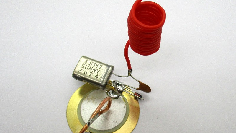

A piezo disk transducer is a handy part for reproducing beeps and boops, and can also function as a rudimentary microphone. Being a piezoelectric element, it can also generate usable power. Enough to run a radio transmitter? [b.kainka] is here to find out, with what may be the simplest possible transmitter circuit.
The active element in the circuit, such as it is, comes from a crystal. This functions as an extremely stable and high Q tuned circuit. When excited by a pulse of electricity, the circuit will carry oscillations in a similar manner to a bell ringing until the pulse is exhausted. A small lever fashioned from a piece of wire supplies the voltage by flexing the piezo disk and a contact, a diode discharges the reverse voltage as the disk returns to shape, and a small capacitor provides an AC path to ground. It works, if a small pulse of very low-power RF near the crystal’s frequency can be described as working.

  1. go one simpler and get rid of everything but the crystal. Make a code key that just whaps on that kind of like a gas grill igniter. Ground one leg, apply the other end to a resonant antenna. It is probably going to start chaotically so it will not be super on frequency but at the amount of power it is generating it probably does not really matter all that much…
  2. A piezo disk can produce quite a bit of power. If you connect a pair of LEDs in opposite polarities across one and tap on it, the LEDs will flash fairly brightly.
