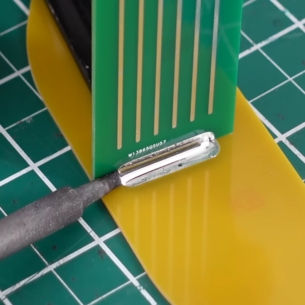

You know those old cliche that the younger generations have begun to cynically despise: “follow your dreams!” “You can be anything you put your mind to!” — well, perhaps they are true on occasion. For instance when [rctestflight] had PCBs that dreamed of becoming a hydrofoil, he found a way to make that dream come true.
It’s kind of obvious in retrospect: printed circuit boards are made of FR4, which is a form of fiberglass, and you know what else is commonly made of fiberglass? Boats. So yes, the material is suited for this task. The fact that solder joints hold up to use in a little remote-control hydrofoil is less obvious, but good to know. It certainly makes for easier assembly for those of us who have developed an allergy to epoxy.
Ease of assembly wasn’t really the point here: the point was that by making the “mast” of the hydrofoil out of PCB– that’s the part that holds the underwater wing– [rctestflight] figured he could (shock!) print a circuit onto it. Specifically, a liquid-level sensor, and because microcontrollers are so cheap these days he went the “total overkill” route of embedding an ESP32 on each mast. He started with a resistive sensor, but since those self-corrode too quickly, the team switched to a capacitive sensor that doesn’t need to form a galvanic cell in salt water. Come to think of it, that might still be a problem with the solder joint between the PCBs. Good thing nobody will be riding this one.
Having such a sensor and brain close-coupled allows for a faster control loop than the sonar [rctestflight] had previously been using to control his hydrofoil’s altitude.. Pivoting each mast with its own servo made for a smooth flight over the water— well, once they got the PID tuning set, anyway. Check it out in the video embedded below.

  2. Huge lede buried here! This is a v1 prototype that was finished months ago. Stay tuned for v2 where he and his team work with a factory to produce these as a kit toy!
  3. It’s better to sense capacity than resistance. You can cover the tracks with coverlay to prevent rusting by electrolysis and contact with water. Since water has permittivity around 80, it’s quite easy to sense. Due to the high permittivity of water, the capacitive approach is not nearly as sensitive to ion concentration and movement speed as the resistive one. And you can detect the capacity change even at microwave frequencies, so you can speed up the measurement rate significantly and thus speed up the feedback loop (or make it more stable).

  5. The solder joint could be made significantly stronger by having the slot through-plated, so that the solder spreads over the whole thickness. Also a few vias keep the copper better attached to the FR4.
