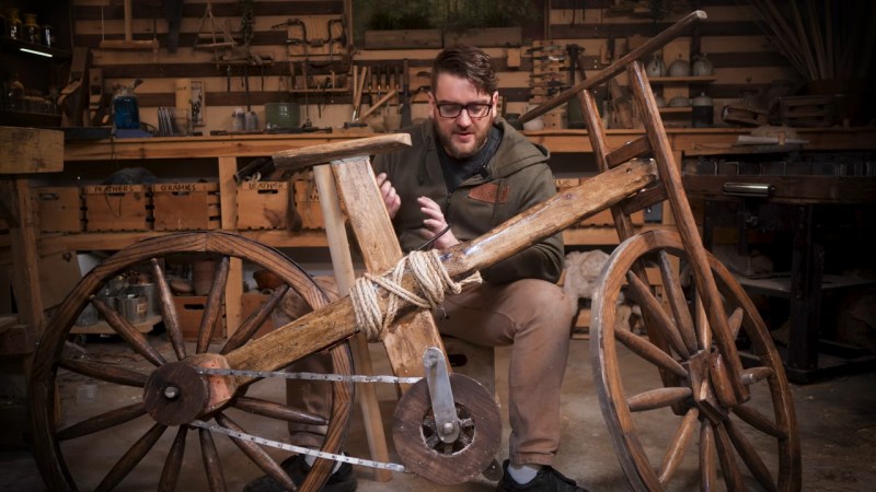

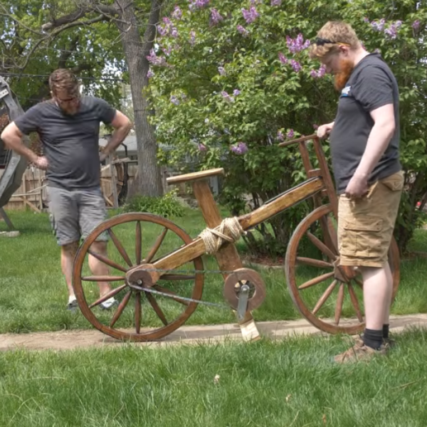

There is a drawing of a bicycle in one of Leonarda DaVinci‘s sketchbooks– except it wasn’t drawn by DaVinci, and dates long after his death, so we can’t say the old master invented the bicycle. We can, however, wonder what it would have looked like if he did– and so did the [How To Make Everything] YouTube channel. As you might expect, they investigated the question of a Renaissance Bicycle in the best possible way: they built one.
In some ways the device looks like the first, primitive hobby-horse proto-bicycle of the early 19th century, which is not without reason. From the renaissance to the dawn of the industrial era, there wasn’t a huge change in how europeans worked with wood, and in both eras wood is the obvious choice. Where this bike differs from [Karl Drais]’s invention is that it has both pedals and brakes– both of them using drawings from DaVinci’s sketchbook.
You might be surprised to learn that ball-bearings are period-appropriate, and weren’t even invented by DaVinci. The drum brake, on the other hand, is right out of the Old Master’s notes: a steel band wraps around a drum on the rear break, and is tighened by a lever. With iron rims, no brake would stop on a dime, and this probably works as well as anything while being quite simple to make.
The chain is also based on one in DaVinci’s notes, and honesty it’s a weak point of the design; they’d likely have been better off with a leather belt, or perhaps a stack of gears as we’ve seen before. The hand-made chain just isn’t able to get the bike up to riding speed. Still, this is recognizably a bicycle and entertaining content for anyone who plans on violating the temporal prime directive or wants to get around after the apocalypse.

  1. A lot of the issues stem from simple manufacturing tolerances. The parts are rough and uneven in size, so the chain catches and wobbles. That may be authentic to some degree, but even in Leonardo’s time they could have easily made it better. For example, by turning the pins on a lathe so the links rotate smoothly. Even without special tricks, working consistently and carefully with simple hand tools and jigs can do a whole lot better.
    One trick is to put paper between the links before you peen the end rivets, then dunking the chain in water or oil. The paper turns to mush and falls out, leaving enough clearance for the links to turn.

            Come back and talk to me when you make a bicycle chain out of 1010 steel and it lasts more than 10-15 km.
          2. Come back and talk to me when you make a bicycle chain out of 1010 steel and it lasts more than 10-15 km.
            While I do that, you go out and make a bag of hammers out of cheese, and tell me it ain’t dumb.
          3. While it’s a bit hard to find correct information among the AI slop, it seems like bicycle chains are commonly made out of 1050 or C50 steel.
            The 1010 steel is about 70-75% as hard and about 60-65% as strong, so it wouldn’t last very long, but it would probably hold on for more than 10-15 km. There are chains made of worse materials than that.

          5. Then there are of course ways to work around the weakness of the chain, for example by making the sprockets bigger. That way the chain doesn’t turn so sharply and it carries less force for the same torque, which both help to reduce wear on the pins.
            Simply making things bigger would also help with the manufacturing tolerances. If you’re constructing a medieval bicycle, winning Tour de France isn’t the goal anyhow.
