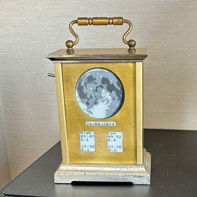

Assuming you’re not stuck in a prison cell without windows, you could feasibly keep track of the moon and tides by walking outside and jotting things down in your notebook. Alternatively, you could save a lot of hassle by just building this moon and tide clock from [pjdines1994] instead.
The build is based on a Raspberry Pi Pico W, which is hooked up to a real-time clock module and a Waveshare 3.7-inch e-paper display. Upon this display, the clock draws an image relevant to the current phase of the moon. As the write-up notes, it was a tad fussy to store 24 images for all the different lunar phases within the Pi Pico, but it was achieved nonetheless with a touch of compression. As for tides, it covers those too by pulling in tide information from an online resource.
It’s specifically set up to report the local tides for [pjdines1994], reporting the high tide and low tide times for Whitstable in the United Kingdom. If you’re not in Whitstable, you’d probably want to reconfigure the clock before using it yourself. Unless you really want to know what’s up in Whitstable, of course. If you so wish, you can set the clock up to make its own tide predictions by running local calculations, but [pjdines1994] notes that this is rather more complicated to do. The finished result look quite good, because [pjdines1994] decided to build it inside an old carriage clock that only reveals parts of the display showing the moon and the relevant tide numbers.

    1. No criticism intended, this is a very nice project.
      I understand it would violate the “low power” ethos, but as the moon imagery is so cool, the thought occurred to me that it might be nice if the moon screen were set back from the bezel slightly, and then edge-lit with some diffused cool-white LEDs.
      Interesting and useful to look at during the day, it would make for a mesmerizing yet functional nightlight. (Maybe the backlight could be activated/deactivated on the basis of the time or, using a photocell, on the basis of the ambient light conditions.
      I agree that, stylistically, a different font and format might be more consistent with the overall aesthetics.
      Bottom line… nice job.
