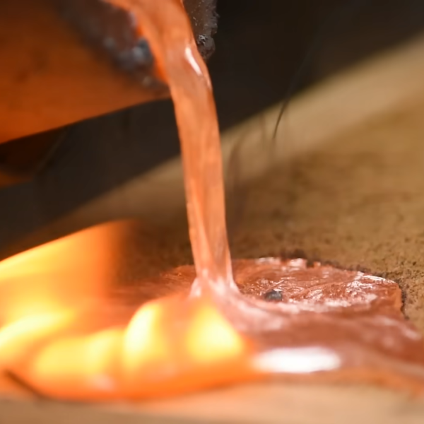

[Chris Borge] has made (and revised) many of his own tools using a combination of 3D printing and common hardware, and recently decided to try metal casting. Having created his own tapping arm, he tries his hand at aluminum casting to create a much more compact version out of metal. His video (embedded below) really shows off the whole process, and [Chris] freely shares his learning experiences in casting his first metal tool.
The result looks great and is considerably smaller in stature than the 3D-printed version. However, the workflow of casting metal parts is very different. The parts are much stronger, but there is a lot of preparation and post-processing involved.
Metal casting deals with molten metal, but the process is otherwise very accessible, and many resources are available to help anyone with a healthy interest.
The key to making good castings is mold preparation. [Chris] uses green sand (a mixture of fine sand and bentonite clay – one source of the latter is ground-up kitty litter) packed tightly around 3D printed parts inside a frame. The packed sand holds its shape while still allowing the original forms to be removed and channels to be cut, creating a two-part mold.
His first-time castings have a rough surface texture, but are perfectly serviceable. After some CNC operations to smooth some faces and drill some holes, the surface imperfections are nothing filing, filler, and paint can’t handle.

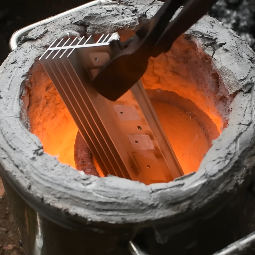

  1. Pic shows him melting a presumably extruded heatsink as a metal source. If any y’all are trying this, I definitely encourage you to choose a starting material that itself was cast. The physical characteristics of different aluminum alloys really affect how the cast comes out. Using pop cans is about the worst, extruded is not so great, high strength zinc/magnesium alloys are so-so, and high silicon casting alloys are amazing. If you have a car junkyard go get yourself some dead engine parts. and melt those. You can certainly cast with extrusions but the results tend to have more porosity and poor detail, and pouring at the right temperature is more important than with an alloy designed for casting.
    1. I have found the opposite to be true. Extruded alu is always better it is a higher grade. It has to be to work in the extrudeing process. Also has a higher scrap value . Cast is always some alloy with different melting temps
    2. Greta advice and a single discarded alloy wheel or dead cylinder head contains way more metal than a whole heap of coke cans or heat sinks.
      Most garages have a scrap pile / bin that contains stuff like this and they’ll either happily let you take it for free or accept literal scrap value (or perhaps a 6-pack) for anything you pick up.
