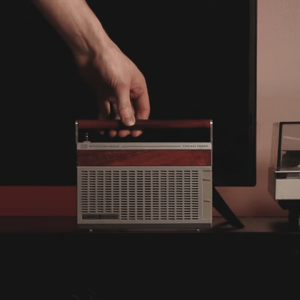

[Distracted by Design] loves gear from the 1980s, though some of it isn’t as useful as it used to be. He happened across a cheap old FM radio with a great look, but wanted to repurpose it into something more modern. Thus, he set about turning this cheap piece of old electronics into a stylish Bluetooth speaker.
All of the original electronics were stripped out, while the original speaker was kept since it neatly fit the case. Electronically, the build relies on a Bluetooth module harvested from an existing speaker. 3D-printed bracketry was used to fasten it neatly into place inside the radio housing, with the buttons neatly presented where the original radio had its tone and volume controls. Power is via an internal lithium-ion battery, charged over USB-C thanks to an off-the-shelf charging module.
Where the build really shines, though, is the detailing. The original cheap plastic handle was replaced with a CNC-machined wooden piece, bolted on with machined aluminium side plates. Similarly, the original clear plastic tuning window was replaced with another tasteful piece of wood that dropped perfectly into place. At the back, the charge port is nicely integrated. Where the radio formerly had a removable door for the power cable storage, it now has a machined aluminium plate hosting the USB-C charge port. Little 3D-printed button actuators were also used to integrate the Bluetooth module’s controls into the case.
It’s a very stylish build, overall. Perhaps the one area it’s a let down is in the sound quality. The ancient speaker simply doesn’t sound great compared to modern Bluetooth speakers and their finely-tuned, bassy audio. However, this isn’t necessarily a bad thing—sometimes it’s nice to have an audio source with a limited frequency response. It can be nice for use in an area where you may want to be able to easily speak over the music.

    1. Hardly fair… obviously a cheapo BT module is hardly hi-fi, but it’s debatable as to whether a cheap transistor radio with a crappy little speaker would sound much better, if at all. Then you have to factor in that there is little if anything of interest to listen to on the radio these days.
      Bluetooth speakers are for convenience; I have an old 60s Pye radio I converted that I use with my phone at work, and it’s ideal for that job.
  6. This would have been much more impressive if they kept all the original electronics, identified the audio amplifier stage in the circuit, and added a Bluetooth module which could be switched in to feed the audio amp.
    1. That’s what I would have done as well as adding an audio input jack. You can get much smaller bluetooth modules that don’t have an amplifier.
  7. Good hack, and I’ve done something similar on lower budget, adding BT module to an old boombox. Since it was a 1980s JVC, the sound was surprisingly good : – ] It had AUX input, so the trick was reasonably straight forward – I opted to solder the input wires on permanently. Still works, ~8 years later, and runs off the batteries, since the BT module had built-in 5V regulator.
    The issue with the old radios (not boomboxes) is their rather low-fi amp matched to the equally low-fi speaker of rather unimpressive kind. Most were made to receive voice bandwidth, not really music, so if you are to wire BT module to the internal amp, it will sound decidedly low-fi. Modern average $1 PWM amp plus similarly average $1 speaker would sound far better, and draw less power, too.
    As sad as it sounds, old electronics are not always worthy scavenging, especially the cheap kind that was used in the pocket radios : – [ (I own quite a number of them, and it is really mixed blessing, some are of such low quality, the only thing that’s worthy saving is the looks – and that’s exactly what this project is about).
