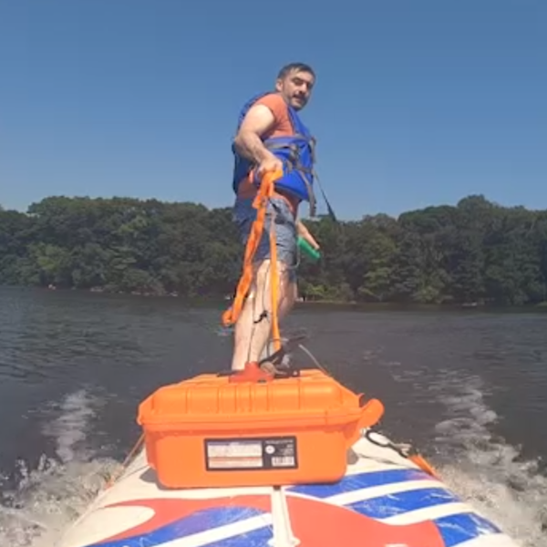

Windsurfing has experienced a major decline in popularity in the last few decades as the sport’s culture failed to cater to beginners at the same time that experienced riders largely shifted to kiteboarding. While it’s sad to see a once-popular and enjoyable sport lose its mass market appeal, it does present a unique opportunity for others as there’s cheap windsurfing gear all over the online classifieds now. [Dane] recently found that some of these old boards are uniquely suited to be modified into electric surfboards.
The key design element of certain windsurfers that makes this possible is the centerboard, a fin mounted on the windsurfer extending down into the water that resists the lateral force of the sail, keeping the board moving forward instead of sideways. [Dane] used this strengthened area of the board to mount a submerged electric motor, with all of the control electronics and a battery on the top of the board. The motor controller did need a way to expel excess heat while being in a sealed waterproof enclosure, but with a hole cut in the case and a heat sink installed on top of it, this was a problem quickly solved.
The operator control consists of a few buttons which correspond to pre-selected speeds on the motor. There’s no separate control input for steering, though; in order to turn this contraption the operator has to lean the board. With some practice it’s possible to stand up on this like any other electric surfboard and scoot around [Dane]’s local lake. For the extreme budget version of this project be sure to check out [Ben Gravy]’s model which involves duct taping two cheap surfboards together instead.

  1. That looks like a really simple build, i like the pushbutton remote, its simple and waterproof buttons with fixed speeds are way easier to build vs a waterproof throttle

  6. It looks super fun and affordable too, but that propeller is slashy slashy yikes!
    Yeah, windsurfs have the daggerboard there and boats have open propellers, but still, this looks like asking for trouble.
  7. The problem with this article is that the Author seem to have limited knowledge of windsurfing, windsurfing board designs and the “true reality”.
    I have been windsurfing for 46 years and still do. I have done deep research windsurf boards with electrical motor drive modifications with both trolling motors & jet-fin drives.
    I have built my own designs with hydrofoil and without with pictures and conclusions on-line.
    Let me elaborate briefly:
    1. Modern SUP (inflatable or not) is much better suited for adding electrical motor than windsurf boards of any kind.
    2. Modern SUP is much lighter (light weight) than old long windsurfing board (the one with centerboard). I own several windsurfing Long boards and they weight is between 16kg and 23kg (35lb – 50lb) when centerboard removed.
    3. Modern SUP is much more stable (without centerboard) than any windsurfing board with centerboard because SUP is wider and has more volume distributed to the sides for stability. Windsurfers did not need it as they held on to the rig (sail, boom, mast)
    4. Old Windsurfing long boards (1970-90s) were not design with any vent screws (only starting from late 90s), over the years developed cracks and could “drink water” making boards even heavier and less buoyant than specs.
    5. There are companies like FireFly that have been offering SUP and/or any board modifications to add electrical motor for more than a decade. Full Disclosure: I have no interest nor any relationship with FireFly.
    6. Adding trolling motor without building proper steering to a windsurfing board is not practical. If you want to steer 3+ meter (9+ feet) board by your feet, your radius of turning will be measured in 100s of meters (100s of feet at least)!
