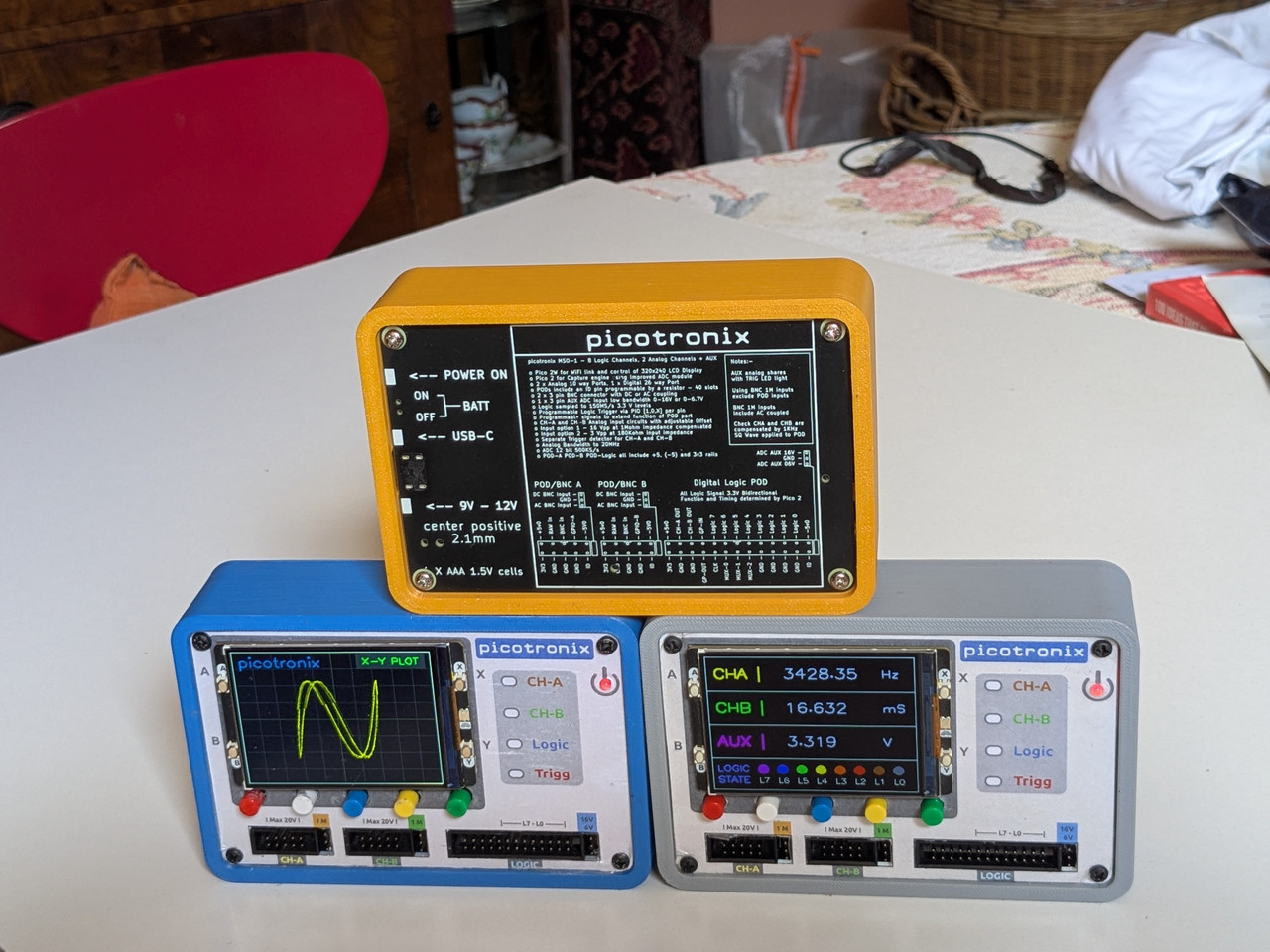

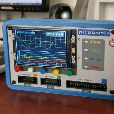

A set of three stacked oscilloscopes is shown. The lower two oscilloscopes have screens and input pins visible, and the top oscilloscope is reversed, with a printed back plate visible.

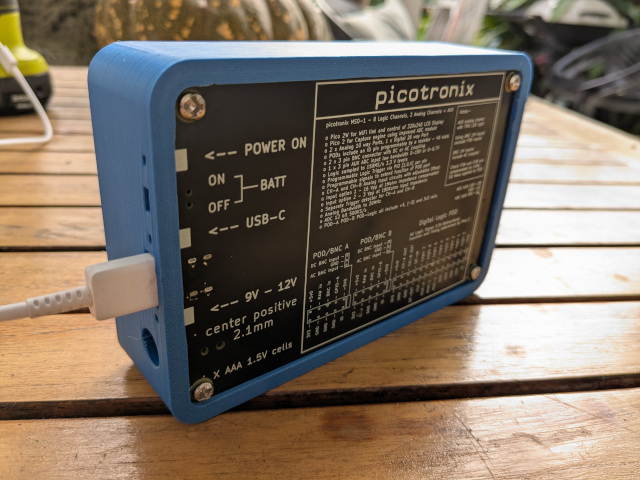

  2. AI-generated make-believe images really don’t add anything to a post like this. If anything they just make me question if it’s just vaporware.
    1. I don’t why they didn’t use just use renders, like some of the other pictures likely are. It would have felt less like a lie, since they should have all the parts if they can render it.
      They later posted real pictures in another blog, but still never more than one.
      1. For what it’s worth I had a good look through all the pictures and it does seem to be just that one. My guess is the physical product exists, but they wanted to show off some software features that don’t exist yet and made an AI edit
        1. Thank you Skwid, this is John the other half of picotronix. I can assure you that every image on the site is real. Some of the original png images (most stored on the website server as well) are over a Mb. I compressed them using squoosh.app to webp, with a setting of around 75. Text detail will be lost with this setting. We wanted a site that loaded quickly. Feedback that this process makes the images look AI generated is a bit of a downer after 14 months hard work, but very useful.
          We would hate to think that makers might be turned off a powerful test instrument targeted at their budgets, because a world saturated with AI imagery that make the non-existent look real, also leads us to believe the real is fake.
          Once I iron out a few style bugs with Flarum, our Forum will be up for comments.
          In response to the useful feedback here, I will try and get a Gallery page up tomorrow ( it is evening in QLD, Australia at present). I will provide the original high-res images, including traces of a signal at the input pin of the RP2350 ADC connected to both the picotronix and a Tektronix scope. We can also prove that we can subsample a periodic 10MHz signal (3dB attenuation) using the RP2350’s native 500kSPS ADC. Lots of pics.
          BTW Jon H – well spotted on the enclosure labels, but they are not AI generated, they look like that because we did not want to use AI.
          Production versions will be silk screened onto a Lexan panel. To provide something for a photo, Norm laser printed the panel onto (expensive) printable plastic from Office Works. Check out the hi-res pics on the forthcoming gallery, you may even see the imperfections where he has cut the holes with a scalpel for the buttons etc.
          Please remember this is a real Kickstarter project with bumps that we are doing our best to eliminate along the way.
          1. The header image that Jon H talked about, “https://picotronix.com/blog/wp-content/uploads/2025/11/picotronix-introduction.png”, has a lot of evidence of AI being used at some point. There is a lot of gibberish text, including “USS-C” instead of “USB-C” or “pasitive” instead of “positive”. The small text is completely incomprehensible. The readable text is still often arranged weird, like how each of the A’s in “AAA” is angled differently.
            Also, this one is a PNG, so it wasn’t compressed. There’s no reason for it to look this way.
            A compressed image like “https://picotronix.com/blog/wp-content/uploads/2026/01/case-back-blu.webp” has no such text distortions and is still readable. Everything is aligned correctly and even the smallest text resembles a valid word. Some of it might be hard to read, but I could decipher it with context.
          2. It sounds like you need to stop using squish or whatever then. Magick can make short work of this, take care of it before this actually causes damage to your project.
            People have every right to be skeptical these days, so work to regain that trust through more transparency. Post ugly photos too, your prospective users are technical people.
        2. They might have had only one completed device and used AI to make a picture of multiple. They have pictures of completed devices in the blog post, but I couldn’t find a real picture with multiple completed devices anywhere on the site, just pictures editted together or AI editted.
          1. Hi Kevin
            I have the original phone shot that the image was taken from – grey backing sheet allowed me to use gimp to do a perspective adjust, crop out the junk around the edges, then scale it down to 640×480. You can see that the display is identical – even the phase of the lissajous figure. Also, if you look at the front decals, the one on the left is not as clear as the other one (prototypes). On the website other photos have this same feature. The 3d Printed cases are also different.
            https://i.postimg.cc/bJWSDg4R/PXL-20251104-020400340.jpg
        1. I think people are so tired and suspicious of AI slop now that we ‘see’ it, whether it’s there, or not.
          Why would they use AI when they clearly have the real thing (other photos clearly show genuine, readable text)? As far as I can see, the ‘suspicious’ image is just downscaled, or perhaps upscaled from a previously downscaled image. Either way, this looks real to me.
          1. It is good to be suspicious, but I’d say it’s a real product due to the other images. These AI for upscale/downscale/small changes are muddying the water, and I don’t like it, but I get why these are favorable over learning basic image manipulation skills. It’s quick, it’s free, and it may even be good enough.
          2. Hi Jan-Willem
            I use gimp. Basic procedure is perspective, crop, background fill, and scale. Basic gimp skills that are pretty quick. It is the perspective, scaling and then compression that seems to distort images. I think that the heavy compression algorithms might be the culprit here. The compressors have to do a lot of tricks to get the images down, and maybe they are doing something that is like what the AI generators use. I am not sure as I don’t know a lot about how the AI image generation works.
            Above, I posted the original from the phone – you can see that they are the same source. I doubt that there is any path to an AI image that can be faster than the simple gimp process. How would I get the basic information into the AI? Show it a photo of the real device? That can’t be a quick solution – it sounds like a nightmare.
            https://i.postimg.cc/zDdTyp0Y/PXL-20250717-233615214.jpg
            who knew AI liked pumpkins?
      2. Yes, the labels on the left side of the front panel of the atop the stack in the lead photo don’t make sense if you read them. Also, the implied resolution is on the order of an iPhone Retina display, something which is not commonly available to the hobby market in that size at an affordable cost. My assessment is that it is AI malarkey, of which there is too much of these days.
        All that aside, it would be neat to make a tiny instrument like that, but it would be difficult to use with a screen that tiny.

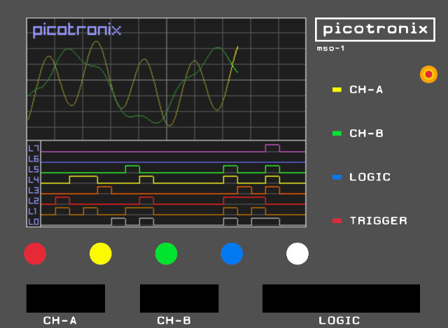

        1. No – the display is 320×240 and it is a pimoroni Pico 2.8″ LCD designed to work with the Pico and pimoroni maintain an excellent graphics library. Their graphics library is written in C and is included in their 2350 micropython image. The library is quite similar to Raylib, without the 3d stuff. In fact, the 2.8″ display is very clear and bright, and (as you can see from the images), it can show nice waveforms. Look closer at the blog posts – you will see three running examples https://picotronix.com/blog/an-introduction-to-picotronix/.
          But wait, these are not photos of the screen – AI shananagains! Because the Picographics is so similar to raylib, we wrote a Pyray wrapper that emulates the picographics library. That way we can drop the micropython code onto a PC python app and run it – so you can see what the pixels are doing. The simple app looks like this –
          https://i.postimg.cc/sXCXbCTJ/pico-sim-640.jpg
          The blog post about Picograms describes how the user interface can be migrated to a PC or external device. The data capture Pico 2 is effectively a server, so it gets a request message, collects data and sends it back via the data link. We don’t have fully user friendly PC software yet, but actually running the LCD software on a PC with the image scaled up would be a fairly easy option.
          I mentioned this in another answer, but if you look closely, you will see simulated phosphor decay on one of the analog traces. The Pico 2 is capable of lots of drawing in a display cycle – which is 10-15 fps. The LCD is slow enough to not flicker, so it looks good. Note that the display Pico is mostly busy with the display, which is why we split the design into two parts – display, wifi and user interface, and signal processor. The signal processor is time critical and can’t be interrupted .
          There is no “AI Malarkey” anywhere here. In fact, the only thing I find Chat useful for is looking up data sheets and general research help. I did use it to help write a polygon function, as raylib does not have a bitmap version. It did a good job there so that was a time saver.

          1. The problem is with the phone that was used to take the pictures. Since I got a new iPhone, component markings in some pictures gets mangled into AI like gibberish. I think these are artifacts of “smart” sharpening algorithms.
          2. @Adrian has a good point. Phones heavily overuse this technology to reduce costs on camera hardware. Fit example, and this is just the tip of the iceberg, if you are using digital zoom at all on a modern phone it is upscaling using an infill algorithm that simulates the contrast of high detail by introducing gradients that don’t exist. This in turn is blended with the image and creates exaggerated distortions.
            I would suggest using an actual camera for product shots anyway, it does not have to be fancy. If you don’t have one, turn off all of the enhancements and consider using a 3rd party camera app that doesn’t do these things. Experiment with your phone to get an idea how bad it is.

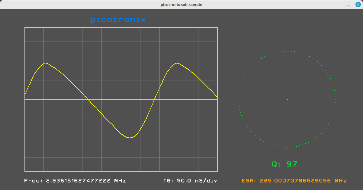

      The 10MHz figure refers to subsampled (ESR) captures using the 2350 ADC. The interesting thing here is that the RP2350 12 bit SAR is actually very good. The internal Sample and Hold and precise clocks allow some fancy DSP tricks. For DSP you need stable low jitter clocks, and the 2350 performs very well here.
      The 2350 ADC is a typical SAR design that needs 2uS to complete a conversion. To do that, it has an inbuilt Sample and Hold that probably has an aperture of 10nS – 20nS. That value is then buffered and converted by the SAR logic over 2uS. The aperture grabs a snapshot of the voltage at the ADC pin, and this is divided by the capacitance tree.
      There are two types of ESR – time domain and phase domain. Early Digital Tek scopes relied on a precise trigger, and then counted a delay to a sample (time domain). These samples were built up over many triggers to make a waveform. We use a phase technique where we measure the exact frequency of the wave, and then convert a set of samples into phase space, overlaying them on a reconstruction grid. The 2350 PIO makes frequency measurement possible with a “trigger” comparator on the analog channel driving a GP pin.

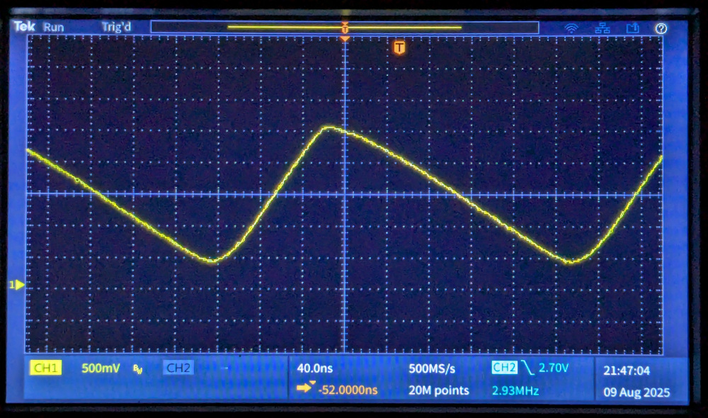

      From measurements, the actual bandwidth (not sample rate) of the 2350 ADC seems to be just over 10MHz. After that the aperture window degrades the signal severely, and a sine wave mostly disappears at about 17MHz. The attached images show a 2.93MHz wave captured on a Tektroix scope at the adc pin, and the reconstructed wave. The ESR value is based on the wave period divided by the number of phase points captured. Only 97 samples were required. The 2350 is accurately replicating the applied wave – as you can see.
      https://i.postimg.cc/fyj6wDsR/cap-2-93-tek.jpg
      what the scope sees
      https://i.postimg.cc/k43r5qz2/buff-offset-600.png
      what the 2350 sees – it is not a sine, so the higher harmonics are being captured

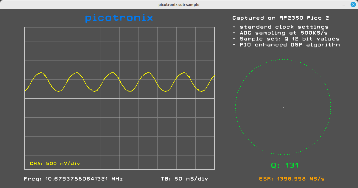

      https://i.postimg.cc/W1Ggynj1/esr-rf-10679.png
      at 10MHz attenuation and distortion are beginning to cut in
      Sub sampling of repeating waveforms is quite well understood. To manipulate sample in phase space you need some DSP and a floating point CPU. The 2350 has those things. ESR is not a single capture – it only looks at repeating waves like clocks and XTALs. One useful thing it can do is plot transfer functions of components like Op Amps – feed a square wave in and see what it looks like at the output. Keep in mind that until the 1GS/s scopes became common, repeating waveforms were all you could see on any scope.
