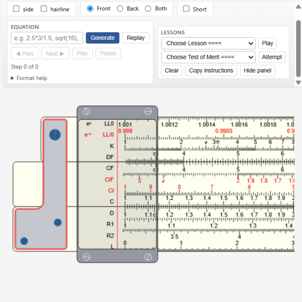

Ever wanted to know how engineers made their calculations before digital calculators were on every workbench? [Richard Carpenter] and [Robert Wolf] have just the thing—a sliderule simulator that can teach you how to do a whole bunch of complex calculations the old fashioned way!
The simulator is a digital recreation of the Hemmi/Post 1460 Versalog slide rule. This was a particularly capable tool that was sold from 1951 to 1975 and is widely regarded as one of the best slide rules ever made. It can do all kinds of useful calculations for you just by sliding the scales and the cursor appropriately, from square roots to trigonometry to exponents and even multi-stage multiplication and divisions.
You can try the simulator yourself in a full-screen window here. It’s written in JavaScript and runs entirely in the browser. If you’ve never used a slide rule before, you might be lost as you drag the center slide and cursor around. Fear not, though. The simulator actually shows you how to use it. You can tap in an equation, and the simulator will both spit out a list of instructions to perform the calculation and animate it on the slide rule itself. There are even a list of “lessons” and “tests” that will teach you how to use the device and see if you’ve got the techniques down pat. It’s the sort of educational tool that would have been a great boon to budding engineers in the mid-20th century. With that said, most of them managed to figure it out with the paper manuals on their own, anyway.

    1. This is cool, you can zoom in on the slide rule and get better accuracy than a real slide rule!
      OK, here’s an example, fairly complex calculation on a slide rule (though easy on a calculator). Cycling in the UK has increased by 50% in 34 years in the UK (ignoring the Covid blip, it’s now returned to the previous levels). So, the growth per year is 1.5^(1/34) . How do we do this? The answer is that we take ln(1.5), divide by 34, then compute exp(that_result).
      On the back we have exp(x). So, we map 1.5 on the LL2 scale to X using the slider. This gives 4.055 (hairline says the same, wow!). It’s really 0.4055. Divide by 34 by moving 3.4 on the inner rule to the slider and then reading off the outer X scale where the inner rule says ‘1’. That’s about 1.192 (hairline says: 1.1926), but it’s really 0.01192, because we started with 0.4055 instead of 4.055 (÷10) and /34 instead of 3.4 (÷10 again). Great, now we just need to find exp(0.001192). It’s on the LL1 scale, because LL3 starts at e (exp(1)) and each scale down is the next power of 10 down. So, the answer is 1.012 (hairline is the same).
      So, that means there’s a (1.012-1)*100=1.2% growth in cycling in the UK per year (on average) from 1990 to 2026. Not great, but better than negative growth!
      1. How much accuracy can you get with the simulator?
        The majority of my slide rules give 4 to 5 digits, even though some are 100 years old.
        1. At first sight it’s the resolution of the screen you’re using. So, maybe up to 4K (3.6 sf). But you can zoom in on the screen giving you a better resolution, though the scale is the same, you can estimate between marks more accurately.
          My British Thornton physical slide rule is about 30cm long, so I can probably estimate to about 0.2mm, a scale of 3.2 sf. Of course, since the scale varies, accuracy does too.

  3. Got a little disheartened when the first 2 instructions wouldn’t work correctly, but it looks like the slide rule modeled doesn’t actually have an A scale, and thus when asked to set window to a value on the A scale, the slide rule just disappears. The other instructions all work as intended as far as I can tell
    1. I found the same, though I was almost frustrated enough after trying those 2 that I almost gave up. It’s a good thing you commented. Thanks for confirming I’m not going crazy.
  4. That simulator is terrible. Its a great idea but done by someone that apparently doesn’t realize what its like to not know how to use a sliderule. Its essentially just as bad as asking someone that knows how to use one from childhood and they say essentially ‘you slide the thing up and down ‘like this’ and then you get the answer. See?’ And if you don’t see they don’t get why.
    For example in the last one I tried it goes through and shows the 1st few steps.. slide the cursor.. adjust the slide .. and it shows you and does it. Thats great! Then a few more and you get to the last line.
    ‘Adjust the decimal place and obtain the result of 209.84.’
    The demo adjust the slide and the cursor to something.. and then highlights the values . .. without explaining it. Then you get to the ‘obtain the result’ part. Somehow I’m supposed to get 209.84 out of this list of values:
    1.00319 0.99682 32.25153 1.00000 1.00000 1.00000 3.14159 3.18310 3.18310 1.78412 5.64190 5.02850
    None of which seem related. OR it made a big deal of animating and highlighting those values for no reason which is also bad.
    Idea 10 out of 10. Execution 4 out of 10, all related to showing a cool animation and automation sequence.
    1. oof I see it reset itself without resetting the values leaving the curor in a wierd place. So you only get a few seconds to see the actual solution before it yanks it away. Yowie thats painful.
      1. The last line on the demos is “now repeat the steps” or something to that effect. The idea is that you repeat all the steps yourself and then you get the result. I can see how the slide/hairline moving at that point is a little annoying but I wouldn’t call it painful.
