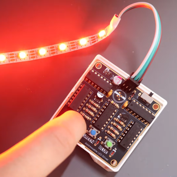

The WS2812B has become one of the most popular addressable LEDs out there. They’re easy to drive from just about any microcontroller you can think of. But what if you don’t have a microcontroller at all? [Povilas Dumcius] decided to try and drive the LEDs with raw logic only.
The project consists of a small board full of old-school ICs that can be used to drive WS2812Bs in a simplistic manner. A 74HC14 Schmitt trigger oscillator provides the necessary beat for this tune, generating an 800 kHz clock to keep everything in time and provide the longer pulse trains that represent logic one to a WS2812B. A phase-shifted AND gate generates the shorter pulses necessary to indicate logic zero. Meanwhile, a binary counter cycles through 24 bits (8 per R, G, and B) to handle color. Pressing each one of the three push-buttons allows each color channel to be activated or deactivated as desired. It can make the strip red, green, or blue, or combine the channels if you press multiple buttons at once. That’s all the control you get—it would take a bit more logic to enable variable levels of each channel. Certainly within the realms of possibility, though.

  1. Cool use of old logic chips. But, you can get the same from non-addressable RGB strips. Cheaper, simpler. An Arduino Nano is cheaper than surplus price of those 5 chips, and you get to address each LED separately. I do respect the effort though. I do projects sometimes just to see if it would work too. A learning experience.
