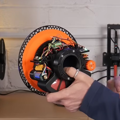

[Matt Denton]’s SpoolBot is a surprisingly agile remote-controlled robot that doesn’t just repurpose filament spool leftovers. It looks exactly like a 2 kg spool of filament; that’s real filament wound around the outside of the drum. In fact, Spoolie the SpoolBot looks so much like the real thing that [Matt] designed a googly-eye add-on, because the robot is so easily misplaced.
The robot’s mass rotates around a central hub in order to move forward or back.
SpoolBot works by rotating its mass around the central hub, which causes it to roll forward or back. Steering is accomplished by tank-style turning of the independent spool ends. While conceptually simple, quite a bit of work is necessary to ensure SpoolBot rolls true, and doesn’t loop itself around inside the shell during maneuvers. Doing that means sensors, and software work.
To that end, a couple of rotary encoders complement the gearmotors and an IMU takes care of overall positional sensing while an ESP32 runs the show. The power supply uses NiMH battery packs, in part for their added weight. Since SpoolBot works by shifting its internal mass, heavier batteries are more effective.
The receiver is a standard RC PWM receiver which means any RC transmitter can be used, but [Matt] shows off a slick one-handed model that not only works well with SpoolBot but tucks neatly into the middle of the spool for storage. Just in case SpoolBot was not hard enough to spot among other filament rolls, we imagine.
The googly-eye add-on solves that, however. They clip to the central hub and so always show “forward” for the robot. They do add quite a bit of personality, as well as a visual indication of the internals’ position relative to the outside.
The GitHub repository and Printables page have all the design files, and the video (embedded just below) shows every piece of the internals.

  1. Mostly a good build but I think he made a mistake by choosing lower power density batteries so that they’d be a better counterweight. Using separate counterweights would not only allow a more optimal battery choice but would allow the counterweight amount to be easily adjusted. This could be as simple as adding a bunch of channels for long bolts along the outer circumference of the battery compartment.
    Also instead of removing the motor encoder covers he could have used something like a clothes iron to dent them slightly and make room, there’s plenty of space between the covers and encoders for this, and this would help keep the encoders clean.
