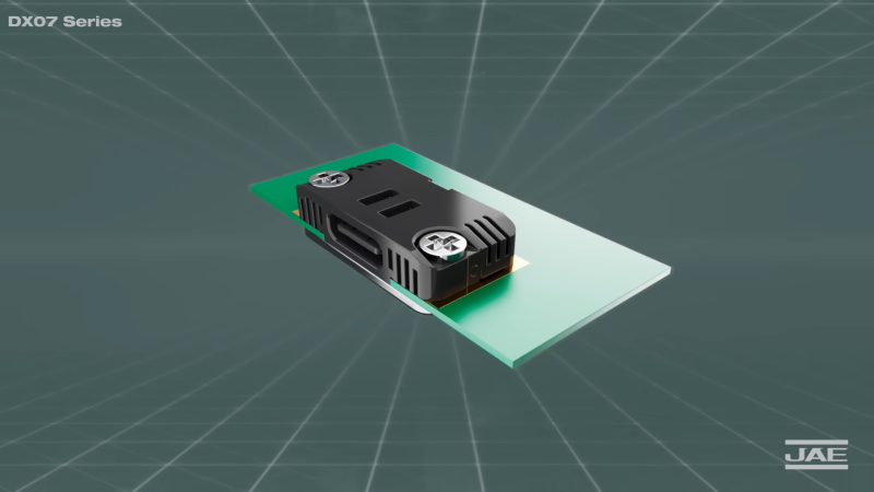

Easily Replaceable USB-C Port Spawned By EU Laws
The USB-C port has become a defacto connectivity standard for modern devices, largely supplanting the ugly mess of barrel jacks and micro USB connectors that once cursed us. While their reliability is good, they don’t last forever, and can be a pain to replace in most devices if they do fail. However, a new part from JAE Electronics could change that.
The problem with replacing USB connectors in most hardware is that they’re soldered in place. To swap them out, you have to master both desoldering and soldering leads of a rather fine pitch. It’s all rather messy. In the interest of satisfying the EU’s new Ecodesign for Sustainable Products Regulation (ESPR), JAE Electronics has developed a USB-C connector that’s easier to replace. Rather than being soldered in, the part is simply clamped down on to a printed circuit board with small screws. As the part is torqued down, small gold-plated contacts are compressed into pads on the PCB to make the necessary contact.
The connector is fully compatible with USB 4 version 2.0. (Don’t ask us how they number these things anymore.) It comes in single and dual connector versions, and is capable of USB PD EPR at up to 240 W (5A/48V). The part does have some drawbacks—namely, the footprint of the metal-shelled part is somewhat larger than most soldered USB C connectors. Whether this precludes its use is very much an application-specific matter for product engineers to decide.
In any case, if you find yourself designing hardware with heavily-used USB C ports, you might find this part useful. It’s not widely available yet, but some parts should be landing at Mouser in coming months. We’ve explored some of the ways USB-C connectors can be fouled and damaged before, too. Sound off with your opinions on this new part in the comments.

  3. So, lets talk about why I think this will not be implemented in common consumer electronics.
    The assembly process is a pain in the ass, you can hardly fully automate this. Compared to the regular USB C connector that can be slapped onto the PCB with a PnP this is way more complex.
    The bottom part has to be placed and somehow secured in place, while the top part is placed (both sides of the PCB has to be worked somewhat simultaneously) then you need to screw them instead of soldering. Way more technicality is required for a higher price and an arguable gain.
    I am all for right to repair, but whats next, a screw mounted resistor?

    3. It’s also more expensive to make, needs tight tolerances for the screw hole and screw to align properly, and the PCB needs to be drilled with tight tolerances (expensive) and the space under the USB port can’t be used so phones with space constraints will be difficult. It’s also much wider.
      Maybe a USB port could be placed inside a socket (daisy chain connectors) so that you can lift out a damaged usb port from the outside without having to replace then socket. That way you don’t compromise the phones IP rating either and you don’t need to unglue the layers that usually make up a phone.
      1. True it will cost more to make, but the “tight tolerances” that you mention are trivial and have been for the last 30 years. To be fair, you’ll never see this in a phone, due to the size. You’d see this in larger products that use USB-C for power or charging and the screws will likely be part of what holds the PCB in place, so no real impact to manufacturing.

      3. Commercial phone PCBs are already drilled with hilariously tight tolerances, plenty accurate for this application. If they weren’t the thousands of microvias and via-in-pad wouldn’t be possible.
    4. BS. it´s already a while that many electronic products are fully assembled by machine. Take a phone for example. And phone are full of spring-loaded contacts. For speakers, antenna ….
      This part can without doubt be mounted by a machine. No sane connector company in 2026 would design a connector for high-density electronic that wouldn’t. And i doubt this part would be significantly more expensive than similar parts.
    5. Not really – the bottom part is not needed and a correctly machined part of the metal case can serve the same purpose. The connectors already in most cases tend to be screwed in for rigidity or the pcb has to bs screwed in anyway, so from manufacrurability point of view, this adds exactly one extra step – placing the top part – when assembling the product.
