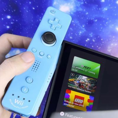

As popular as the Nintendo Switch and its sequel are, it’s hard to argue that its click-on Joy-Con controllers are ergonomic, barring you having very uniquely shaped hands. This thought and a stack of Wii controllers led [KOUZEX] to the mad project of merging Joy-Cons and WiiMotes into what can affectionately be called Wii-Cons, or perhaps JoyMotes.

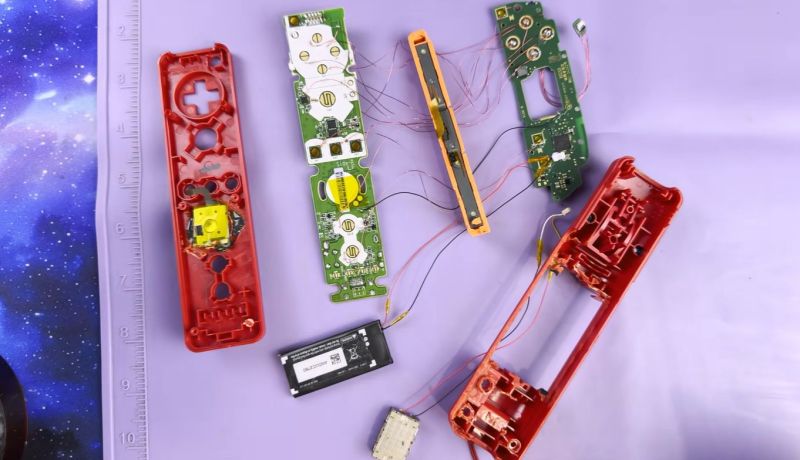

Suffice it to say that it’s not a very clean or easy mod, and you could definitely make the point that a custom PCB and 3D-printed shell would  have been a lot easier. Making space for the Joy-Con’s side rail, thumb stick and PCB without simply tossing the WiiMote’s PCB was a tough ask, and these are two WiiMotes that will never connect to a Wii again.
With the WiiMote-shaped Joy-Cons working pretty well after all that work, the issue of remapping Joy-Con buttons that have no match on WiiMotes was probably the biggest headache. Here having said custom version could be rather helpful to have more control over the button layout, also to not have to keep harvesting the dwindling supply of WiiMotes to make WiiCons. It might even be possible to keep all the WiiMote functionality that way, to really blow people’s minds when you use your fancy Joy-Cons to next play a game on an original Wii.
