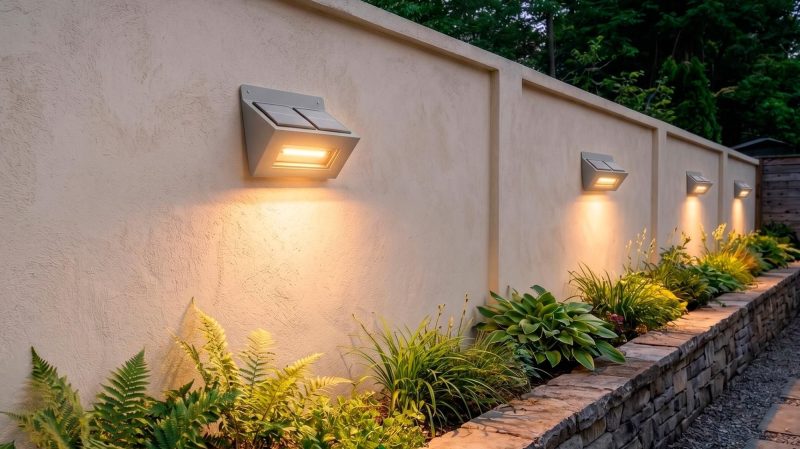

In this modern age, if you want a truly swish garden that makes your friends sad when they visit, you need good lighting. [technocraftStudio] has been working on just such a project, creating custom wedge lights to illuminate garden beds in style.
You might look at the plastic housings involved and assume that they’re 3D printed, like the vast majority of such projects we cover these days. Instead, the enclosures are crafted out of PVC plastic, harvested by flattening sections of pipe with a heat gun. It has the benefit of being highly weather resistant, and cheap to boot. The lights themselves are small LED panels mounted on aluminium plate as a heatsink, and fitted with an acrylic diffuser to spread the light out more evenly. Power for the lights comes from an 18650 lithium-ion cell, charged by a pair of solar panels hooked up to an MPPT charge controller. A TP223 capacitive touch module is also included in the design to allow the lights to be turned on with just the touch of a finger.
The result is a surprisingly stylish bit of garden furniture which provides warm, even light and, ideally, needs a minimum of maintenance and attention since the sun provides the power. We’ve featured some other great solar lamps before, too, like this lovely Pokemon-themed build. If you’re building your own solar projects at home, or doing weird things with PVC, we’d probably love to hear about it on the tipsline!

  3. Checked out the instrucables but couldn’t find what MPPT charge controller he used, did I skip over it or did he leave that out?
    1. It’s a CN3065 solar charger module, there are two pictures of it in the instructable but you have to click “more images” in the relevant sections. It has a built-in MPPT and seems a reasonable match for the used panels.
    2. The pictures show a charger module based on the Consolance CN3065. The datasheet doesn’t talk about MPPT, but mentions a “Charging Current limited by the Output capability of Input Power Supply” feature.

  6. The PVC enclosures are the clever part here. They avoid the layer lines and UV concerns of a quick 3D print, while the wedge shape puts light exactly where it is useful instead of spilling it across the yard. I would be curious how the battery compartment is sealed for winter rain.
    1. Technically you don’t actually need to seal outdoor electronics, as long as it won’t die to condensation settling on it and you have a path that lets water drain out freely enough wet weather won’t matter much.
      Conformal coatings, gaskets etc wouldn’t be a bad idea but other than higher voltage stuff where arcing just from humid air could become a problem if you let any moisture in you should get a pretty good lifespan just from having a good drain path so the electronics never actually sit in water.
  7. Not trying to be negative here, but unshielded wallpack style lighting creates potential issues with glare, and light trespass into neighboring properties. It would be better to design with cutoff shielding to ensure the light goes where it is needed on the property and does not spill out unnecessarily to the sides.
