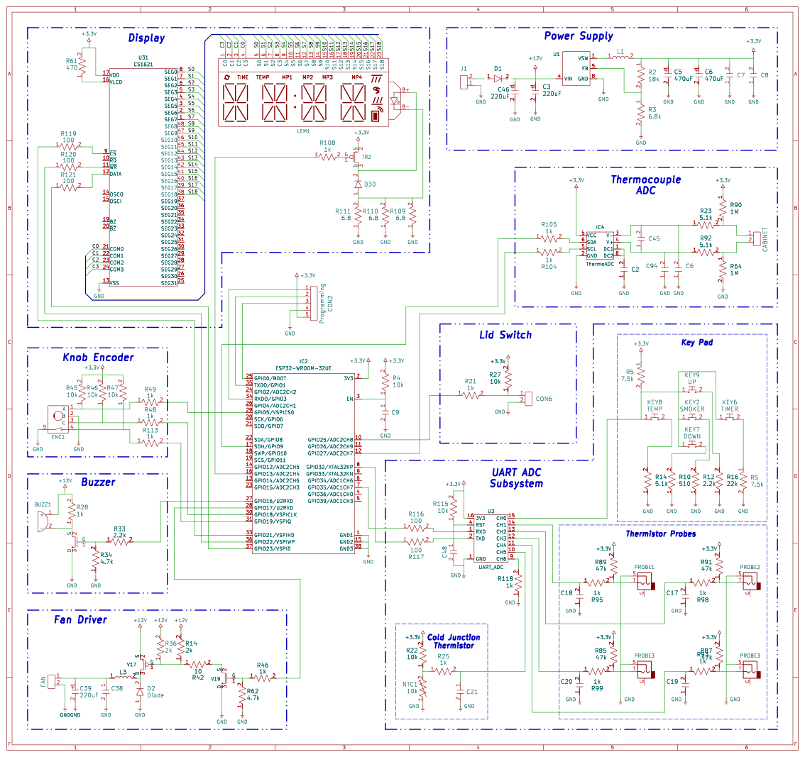

The first order of business in creating the firmware is reverse engineering the original controller. Opening it up immediately reveals an ESP-32 and a well-labeled programming port. The rest of the control board is equally simple, including connectors for four thermistor temperature sensors, lid open/close switch, fan driver, 16 segment LCD, piezo buzzer, and some physical inputs.
The thermistor along with the physical inputs are connected to a 16 pin chip, interfacing with the MCU over a 9600 baud UART connection. [PRBS23] cannot determine an ADC chip meeting these specifications, so the most likely answer is a cheap MCU programmed to act as a simple analog fronted.
The neatly labeled programming header is used to quite easily dump the firmware with the espflash utility. Analyzing this dump reveals a rather strange ADC correction function used by the original firmware. The necessity and overall utility of this function remains unclear, does corrects a maximum of around 40 degrees Fahrenheit.
Most of the other features ended up being at least somewhat easier. The CS1621 segmented display driver is reasonably well documented with datasheets making its implementation far easier. Likewise, the other odds and ends were implemented in a far more normal manner compared to the thermistors.

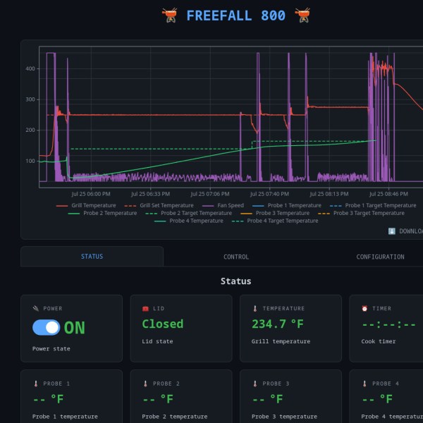

All this reverse engineering work got tied together into a neat little firmware package. It comes with over the air updates PID controlled temperature, and a real-time web interface. This also isn’t the first time we have seen an IoT device liberated from proprietary firmware, and this remains one of our favorite uses of reverse engineering!

  3. That is a very nicely drawn schematic. In my Quest of improving my drawing skills there is certainly stuff here i will incooperate in my drawing skill.
    The only thing I’d probably do differently is that I’d move inputs to the left, probes, keypad etc and outputs to the right, buzzer, screen.
    I also always struggle with the wire vs bus vs label thing. Your wires look nice. nicer then what I end up with. Because of that I draw a bus between blocks so I end up with fewer (crossings) and wires over the schematic. But it always makes me wonder, am I allowed to do this? Are there EE’s turning in their grave now? I2c is a bus, so it can be in a bus. Spi, UART too. But that single (or group of) gpio, what is that … Not to mention, when do youvuse a label. In simple diagrams like thus it’s overkill, in more complex diagrams its needed, or do hierarchial, but there’s even an anti voice on that, just use bigger scheets.

  5. On U4, where are the I2C pull-up resistors? What are R104 and R105 doing in series?
    Great job, a UART ADC caught my attention as a new part idea.
    1. The interface to IC4 (the thermocouple ADC, I’m assuming this is what you meant by U4) is not I2C, or any kind of open collector type interface. Instead it is a bidirectional interface where both the ESP32 and the ADC drive at least the SDA (Serial DAta) signal.
      I can’t speak to exactly why the designers put R104 and R105 in there, but my suspicion at least for R105 is that it limits the current in the case that both the ESP and ADC drive SDA at the same time. Since it is a bidirectional data signal. That’s not really an explanation for R104, as only the ESP32 drives SCL (Serial CLock), maybe that just put it in for symmetry.
