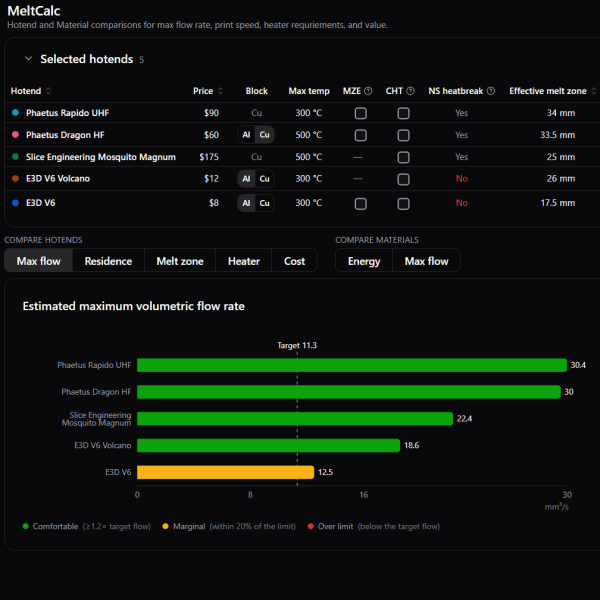

When it comes to 3D printing in the FDM world, you can go a long way just relying on standard settings that ship with your 3D printer and/or slicer. If you want to push the limits, though, it pays to better understand the hardware and materials you’re working with to know what you can get away with. To that end, [Robert Samples] put together the MeltCalc database to help.
The purpose of MeltCalc is simple—it collates data on hot ends and materials regarding factors like maximum flow rate, print speeds, and heater requirements. If you’re wondering whether a given hot end can flow a given filament at a given rate, for example, this tool is a great place to start. It features 64 different hot ends and 36 polymers typically used in the 3D printing world, and can spit out maximum flow rates and print speed estimations even accounting for fancy tech like Core Heating Technology (CHT) nozzles. It’s all based on thermodynamic modelling which [Robert] put together based on his experience as a chemist who works with polymers. His aim was to provide a tool with realistic flow rates for hot ends, so that end users don’t have to just rely on often-optimistic marketing numbers.

Robert (site creator) here I definitely do want people to submit hotend melt zone length measurements either by creating a PR on the github or just creating an issue and listing the base hotend specs and I can update the database with your numbers!

Users submit entries to my by GH issue or make a PR with a database change and I merge the new entries so it is curated and checked for accuracy
and as a note everything works based off the length of the heated portion of the heat block/melt zone so values are downstream of an objective numbler and the flow rates are extrapolated using a thermodynamic model of each material

Curious how convergent with real world experience this modelled approach will end up – the filaments are full of unknown additives, the nozzles less than perfectly made/worn/contaminated, the thermal regulation of hotend/bed/chamber etc, its a complex problem to really get right from calculations alone. Don’t get me wrong though I like the idea behind the project and it should at least be a reasonable sanity check so that first print hopefully works well enough.
Thanks for the thoughts! Long reply with some of the technical details-
I’ve found it to be pretty convergent with expectations but you are correct additives and filament brand will change quite a bit. The flow calculations will also change a bit per hotend based on how well they couple the heater to the filament path. Another big factor is the extruder, with a powerful extruder you can still push semi-molten material out but it will have poor layer adhesion. I have only really considered vanilla base polymers, once you get into stuff like HF-PLA you get weird additives starting to come into play. PC is also hard because a large fraction of the stuff on the market undergoes semi- or undisclosed- blending with PETG or ABS (sometimes you can get hints as to how much from the MSDS).
In practice wear on the nozzle and contamination of previous filament wont affect much as most material is scoured from the melt zone quite effectively and heat transfer within the polymer tends to dominate so doubling the thermal conductivity of heat block (eg going from aluminum to copper) only nets you a small increase in flow.
The chamber bed etc are somewhat independent of the hotend the model assumes the use of a sock and sufficiently powerful hotend heater however there is one caveat where this applies. The place it does affect things is on high temp crystalline polymers where the cooling speed and layerbonding bottlenecks you so I give the theoretical melt capacity of the hotend in addition to a derated reasonable value when you are looking at something like PPS for example. The theoretical value should be close to what the hotend is actually capable of doing based on the thermodynamics and energy required, but its not something anyone should actually print at unless you are doing something crazy like using an industrial pellet extruder.
TBH in my mind its not really a substitute for doing a max flow rate test and temp tower on a new material, I see a lot of the value in understanding comparatively what the top end on different materials is roughly, and also in understanding which hotend to buy. Its very hard to parse what the real price/performance difference will be when you only have the marketing numbers. Like microswiss advertises 50 cubic flow on their flowtech hotends but they are very short printing perspective did a video with real testing and showed layer adhesion drops at 21.4 cubic for the flowtech CHT with failure somewhere above that. My model still overestimates flowtech a bit but its much closer to when it would actually fail relative to his numbers, but its still than the advertised number. Giving the consumer more complete info to answer the “Is this thing really work $85 to me” question is what I’m hoping for.

BTW I now have a validation dataset- error is less than I thought it would be (I did not change any of the model settings to fit the data either) the median error in flow estimated max flow is ~25%. There is a validation data comparison here https://meltcalc.baconmilkshake.com/validation
