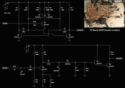

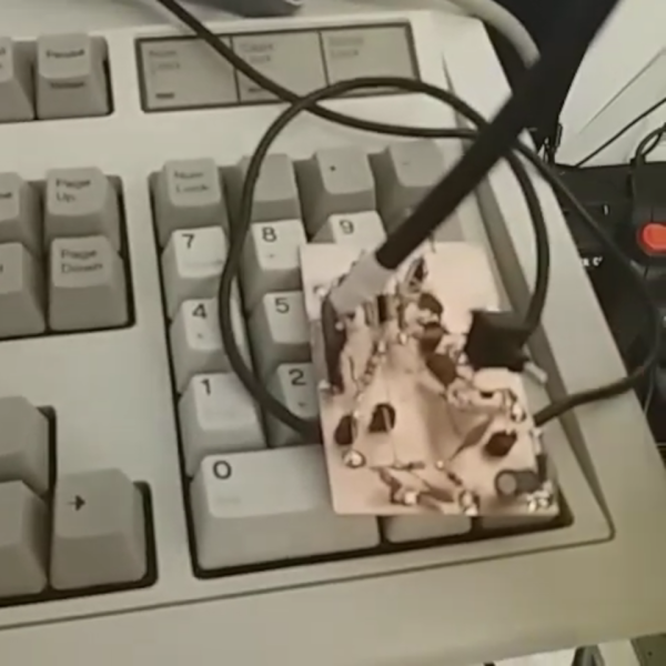

These days, modems are pretty fancy bits of kit, what with to keep up with the speeds of cable, VDSL, and fiber connections. At lower speeds, though, it’s entirely possible to build a modem out of simple discrete components. [sv3ora] did just that, building a simple modem for the CB2 Micro.
It’s a remarkably simple build.
The project takes advantage of the fact that the V1.54 firmware for the CB2 Micro enabled 75 baud serial communication. Thus, it made sense for [sv3ora] to build a 75 baud modem to suit. As was the way in the days of dial-up internet, the modem modulates data into audio, demodulates audio back into data, allowing the CB2 Micro to send and receive data over telephone lines, ham radio links, or to store and retrieve data via mediums like cassette tape.
The device is built out of good old BC547 transistors. along with a smattering of diodes, resistors, and capacitors as supporting hardware. That’s all you need to turn slow serial into audio and back again. [sv3ora] does a great job of demoing the hardware, using it to store a program on tape and retrieve it again later.

    4. The slow 75 baud speed is definitely a key factor in what makes this design so simple, as it avoids having to use any kind of clock synchronization or complex filtering within the modem itself.
      But there’s no doubt it’s a proper modem; it audio frequency shift keying (FSK) to modulate and demodulate serial data, exactly what most “real” modems also did up to the beginning of the 1980s.
      As the creator points out, it uses the same fundamental protocol as the Bell 202 modem from 1976; only the 202’s higher baud rate makes it incompatible.

  2. Hi folks,
    Cool to see my JHOC (Just A Handful Of Components) modem appear on Hackaday, plus your nice comments!
    To make a simple modem out of discrete components, I had to reduce the UART speed of the CB2 micro firmware to 75 bauds. 75 bauds was a nice division from the previous 2400 bauds used, which I sacrificed to achieve the lower speed with simple dividers (1200 bauds still available).
    Note that the modem could cope with a bit of higher speeds, but I have just not tested this yet, I have only tested it at 75 bauds.
    The modem had to be discrete and as simple as possible, to match the philosophy of the CB2 micro: “a single chip 8-bit through hole components computer, with as simple hardware as possible, easy to program and use, with as many features as possible”.
    2 more stages (a mosfet for low loading, driving a small speaker, and a microphone preamplifier) would make this modem to have an embedded “acoustic coupler” with lots of volume to communicate “wirelessly” (audio) on a silent room with a computer.
    I plan to do those changes (I have actually tested the mosfet), cause they do not cost much on components and add those nice features.
    This modem does not include any mark/space filtering, so it expects a clean line (like a telco or an FM transceiver). For noisy HF HAM radio, any filtering is performed in the transceiver anyway (those have already RTTY mark/space filters).
    BUT, because the actual modem does not depend on filtering, it is very tolerant on frequency variations (with temperature changes).
    Note that this is just the modem with the set of frequencies. Any data protocol can go through. The CB2 micro uses ASCII but HAM radio uses BAUDOT.
    The intention was to use this modem as a way to store programs on a tape, acoustic coupling programs exchange and through HAM radio too. I have only tested the tape part on a BAD recorder, yet it works fine. I have also tested the whole thing on the oscilloscope to verify the operation.
    I would love to see your comments on this, as I have never found a simpler low speed modem, no matter of how hard I searched on the net. This might be the simplest modem one could build. JHOC modem!
