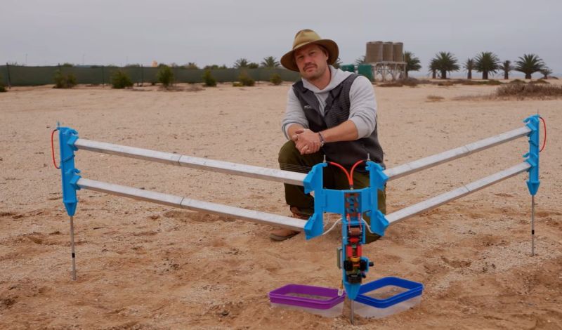

As fun as mucking about with simulated environments in a laboratory is, at some point you have to do those field tests to demonstrate that your prototype actually works in the real world, under real conditions. This is what the [Plasma Channel] recently did for their fog harvesting system by setting it up in the Namib desert.
We previously covered the atmospheric water harvesting attempts, using electrostatic precipitation to draw the moisture in the air onto the collectors where it can then be harvested. This is rather different from existing approaches with e.g. fine meshes and hoping that enough water molecules bump into your mesh, so theoretically it should be much more efficient. In the lab it worked well, but reality always has the last word.
The Namib desert is at the top of the world’s most arid regions, competing with the Atacama desert. What it does have going for it is regular fog rolling in that lasts until sunrise, providing a good target for water harvesting. Interestingly, this field test was performed together with the University of Namibia.
Of course, moving the prototype in check-in luggage for the flight to Namibia took some redesigning and testing. Fortunately everything, including the solar panel, arrived intact, allowing trials to commence. This initially took place at the campus of the University of Namibia, joining a number of other atmospheric water harvesting projects that had been previously installed there.
Unfortunately the fog proved to be rather elusive, leading to a few fruitless attempts. It also proved that the salt in the air from the ocean spray, even a few kilometers inland, was highly corrosive, especially to high-voltage electronics. Although the system basically worked, happily harvesting water under the right conditions, it does need some redesign before it’ll be tested next in the Atacama desert.

    2. Badly. It uses enormous amounts of energy per gram of water.
      This guy is the epitome of overstatement. “Wildly successful” and “promising” my ass – he even calculated the energy per gram and if I remember correctly it was kilowatt-hours per liter. Yet he thought it was promising for irrigation, which needs tons of water per day.
      1. Previous video with artificial dense fog: 21 ml/Wh which translates to 48 Wh per liter. Of course in this video they managed to collect absolutely nothing under real world conditions. Just some condensation on the rods.
        So, you might spend a laptop battery’s worth of electricity to get 1 liters of water, or about 21 liters per kWh.
        Here’s the thing: for the cost of a laptop battery, you could buy a whole lot of plastic screen mesh and simply build a bigger fog collector with no running costs in electricity.
        1. Solar energy is running at around 15-20c/kwh over lifespan, and reducing rapidly. 1c/litre for water makes sense in lots of applications. So let’s not right this off just yet!
  1. What was result? We are working on system at IIT Chennai India. We want system giving about 2000 litres per day, solar based power.
    1. Nothing. It broke down because moisture caused arcing in the transformer.
