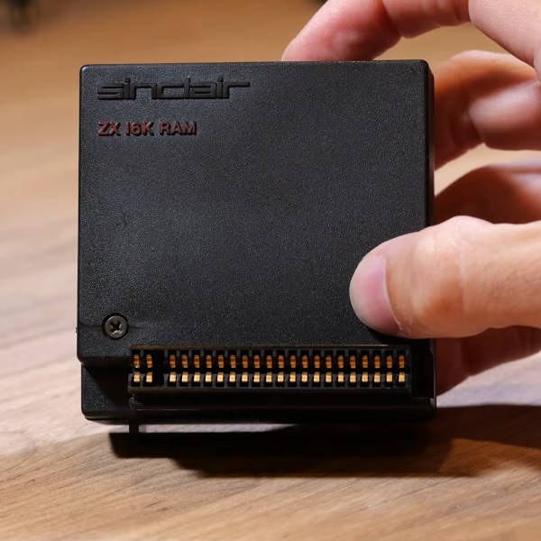

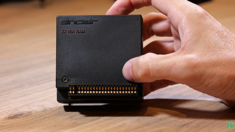

How A 1981 RAM Expansion Worked
Sir Clive Sinclair and his company were notorious for pushing the limits of electronic parts in search of a low price, and his ZX series 8-bit computers were fine examples of this art. The ZX81 came with a meagre 1K of memory, and a popular upgrade was a 16K RAM pack. [Happy Little Diodes] has opened one up, and to his surprise, found many more parts than expected.
Inside the box is a pair of PCBs connected by ribbon cables, one of which has a selection of 74 chips and the other the 4116 RAM chips and a discrete component power circuit. This complexity comes from that cheapness, the 4116 is an inexpensive DRAM chip and requires an eclectic set of power supplies.
The functions of address selection are straightforward enough, as is the DRAM refresh circuitry. The power supply is clever in that it’s a self-oscillating switcher that provides +12 and -5 volts with a single transistor. We particularly like the quench diode in the 12 V Zener diode regulator  circuit.

  1. I had one of those! A ZX81 with the 16K RAM cartridge, that is. It only worked (sort of) when held in place with a some fat rubber bands.

    2. Yes! any bump caused the cartridge to scuttle RAM contents.
      Since the keyboard presses alone caused the main CPU to move around, it was going to happen.
      The edge-card connector seemed OK but nothing to hold the expansion module up.
      I made good money adding heatsinks and (input series) diodes for the 5V supply to stop overheating on ZX-81’s. The 16K RAM extra load was too much.

  3. In later versions of the Sinclair ZX81 memory expansion there was only one pcb inside. They put all the 74ls logic in one custom chip.
      1. Yes they did. It is an issue 3 pcb with only 8 x 4116 ram, 1x 74ls157 and 1 Ferranti DIP20
        ULA with datecode 1982 week 38.
        I have a hugh collection of sinclair with more then 30 16K memory expansions so can compare them.

  12. The simple solution to ram pack wobble was a 2cm ribbon cable, the cable could flex sufficiently to absorb the motion decouple the two so as to keep the RAM contents safe.
    It took a little bit of soldering, but since I was an 11-years-old kid who bought it as a kit (PCB + all the chips, resistors, capacitors etc) and soldered it together myself (hey, I think my pocket money was £1/week back then, this was already a serious savings effort), this wasn’t a big deal.
    It looked a little bit messy because, being 11, I couldn’t just order components from RS/digikey, but there was a kindly old guy who ran an electronics surplus store who could get stuff and who didn’t care that his customers voice hadn’t broken yet :) And it worked a treat. These days I’d make a kickstarter :)

    I had a few RAM Pack wobble crashes, but I largely solved mine by mounting the ZX81 itself on a book, so the RAM Pack would hang off the end rather than touch the table ( I used it with the 14″ B&W TV I inherited from my Grandad).
    The height of the RAM pack made it worse though, because it would act as a lever at the edge connector end.
    I think with a bit more foresight, Sinclair could have vastly improved RAM Pack reliability. The RAM Pack appeared for the ZX80 a bit before the ZX81 appeared, so the ’81 could have been designed with it in mind (also, there were 4kB RAM Packs for the ZX80 too). By designing the plastic moulding for the pack to include two plastic tabs and screw holes, users would have been able to fit them just under the main body of the ZX81 and secure the pack with a couple of short screws. The cost, even by Sinclair standards would have been minimal, easily enough to cover the return rate.
    But expansion for a ZX81 was precarious by design. The ZX Printer was a plug and edge connector that fitted between the main body and then the RAM pack hung off that. My solution above would have helped there though.
    Hmm, pity Hackaday doesn’t support even simple bitmap images, nor the ability to insert ASCII art diagrams.
    1. Yes, so looking at the video it’s actually worse than I thought. The RAM Pack does in fact have two small extensions that protrude down from the bottom, so the pack can rest on the table – which will make things worse!! You can see this at around 2:38.
