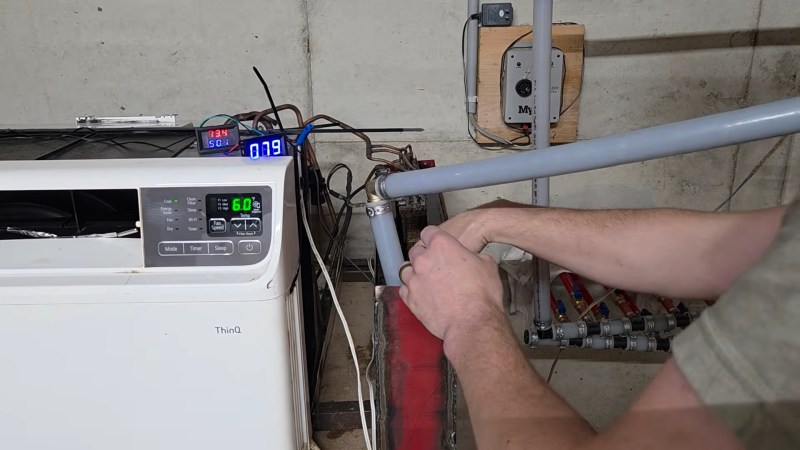

Heat pumps are great, because they pump heat around, and we often don’t want heat where it is. Need it somewhere else? Pump it! It’s great. It’s also a bit pricey if you’re buying new, but [Craftsman Chris] over on YouTube realized that the window air conditioning unit he found in a dumpster is, in fact, a heat pump. Normally it’s an air-source heat pump, but with a delightful series of hacks, he gets it automated and hooked into a ground loop in his latest YouTube video.
The heat sink is provided by a bunch of PEX tubing [Chris] buried in his back yard. After experimenting with using the water loop for cooling directly, he realized that pumping heat out of his house into the cold ground would go much better with a heat pump. That’s where the window A/C came in. After cleaning and servicing it, it was time to convert it to dump heat into water rather than outside air. To do that, [Chris] welded up a tank made of scrap metal around the existing heat exchanger. It’s designed for air, sure, but water takes its heat just fine. The nice thing about this is that by keeping the internals of the air conditioner mostly stock, he doesn’t let out any of the tasty, tasty CFCs that may be hiding inside.

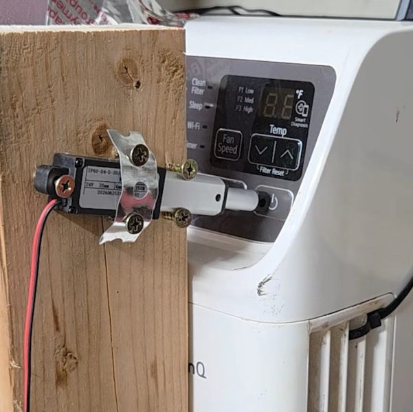

Connecting this unit to his thermostat is equally hacky– he takes an old Programmable Logic Controller that looks fit to run a small factory, and hooks it to a single linear actuator to poke the A/C unit’s stock power button. Is it elegant? No. Does it work? Yes. Is it a hack? Indubitably!

Installation cost. I wanted to do it for the house I built 20 years ago and the payback period was 20+ years. The video shows a slinky coil version that ins placed in a shallow pit, which is less expensive than drilled wells but not as efficient. Shaking hands with someone who owns an excavator costs more than the air-to-air heat exchanger on a typical split system, and getting a drilling rig out to your property for boreholes costs more than an entire air-source HVAC unit. Plus, water-source heat pumps (in the US) are crazy expensive because the volume of sales is low, the expertise for installation is rare and the companies selling the systems feel entitled to a percentage of your savings for their marketing acumen. (Yes, I know a guy who sells and installs them; he’ll admit to every word of that)
I quite like it, but very overkill. Honestly i would have just put a car radiator in front of the condenser, and keep the AC as close as original as possible.
Or at least put some heat exchanger between the ground loop, and the water in which the condenser is submerged, and put some corrosion inhibitors

I think that using an intermediary working fluid with very low specific heat would ruin most of the efficiency gains. You want the water. Getting splashed with water at 200 degrees is a lot bigger of a problem than having 200 degree air blown at you. You are effectively thermally insulating your heat pump.

The PLC cobtrolled physical switch warms my frozen heart enough to make it sweat slightly.
