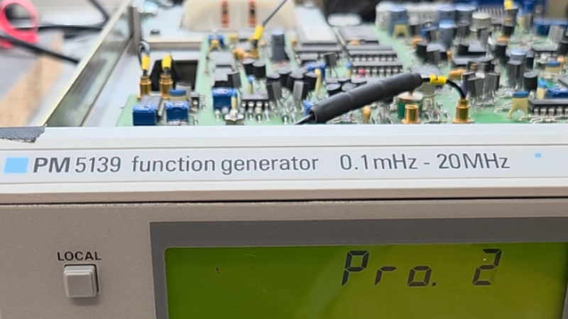

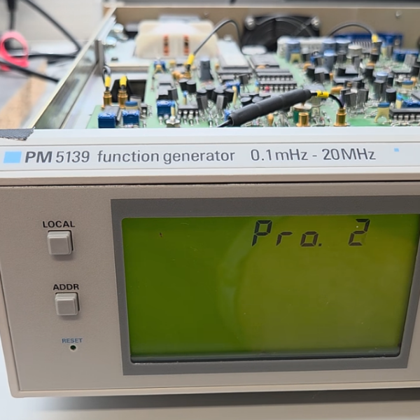

The Philips PM5139 is not famous. It won no great victories on the battlefield, nor was instrumental in changing the political landscape. It was just a useful function generator that you might find on a workbench somewhere, doing its job quietly and relatively accurately. [doctormord] has been doing the work to reverse engineer this humble piece of hardware.
The PM5139 is poorly documented; the only existing service manual out there is for the PM5138A, a less-capable sister model. Hence, there was some value in reverse engineering the device to understand it better. Work started with two EPROM dumps capturing what Philips put in the box all the way back in the early 1990s. From there, the code was examined and tinkered with until [doctormord] felt confident to modify it and improve upon what was already there. This was achieved with the aid of an 8051 emulator that could run the code to make it obvious what was going on. The result was a custom “V2.0” firmware that adds six arbitrary waveforms to the function generator and the ability to play simple music, amongst other tweaks.

One of the “fixes” is smoothing programmed waveforms. Wouldnt those samples be dithered on purpose?
Hey rasz, that’s something I couldn’t find out if it’s either on purpose or not. The service manual also doesn’t give any clue on this. I also can’t find any fully complete service manual, the one for the 5138A is missing important parts for the whole Controller/Digital setup.

Next thing would be to implemented MIDI and or using the Modulation output on the backside as a second independent output for another instrument via PCM or SQ-wave noise forming.
Claude’s writing style aside, I really liked this generation of Philips devices. They were solid, competent instruments, with new digital functions, well thought-out controls and great functionality at a good price. And coming at a time when Tek was rudderless and waning trying to come up with decent new digital scopes, and HP was commanding much higher prices. They had a real shot at taking that market segment, then… crickets. What happened? Couldn’t find a sales channel or a competent marketer?
It came at a time where Philips was restructuring (no longer a do-all almost state-owned company) and sold the whole T&M department to Fluke. One example is: all the Philips counters were made in Sweden, that company lives on as “Pendulum Instruments” today.

In the meanwhile “we” investigated further to use this device as something like a wavetable synth, and it does pretty well. It now plays “chords” of 3 to 5 with envelope/sustain/attack for the notes. This is the latest outcome:
https://youtube.com/shorts/RJKwy_QURL8
How thidsworks is explained in the video description.
