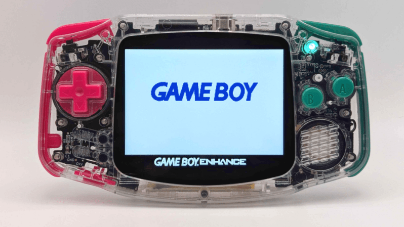

[Bucket Mouse] has long been a fan of the various iterations of the Nintendo Game Boy. Now, he’s turned his eye to the Game Boy Advance, building an enhanced version for the console’s 25th anniversary.
There are plenty of ways to mod an existing GBA to be better than the original, but this build recreates the console from the ground up. It’s basically a brand new motherboard that replaces the original entirely, requiring only the CPU and RAM to be harvested from the original board.
It’s perfect for when you find a badly-damaged handheld that needs heavy repair, because every other part on the board can be purchased new. You can buy a nice shiny screen kit online, and even upgrade to LiPo power if so desired. The new motherboard also eliminates sound issues that are common when upgrading the screen in a classic GBA, and there’s stereo audio available on the headphone jack as standard. Battery life is also improved compared to the original.
If you’ve got a haggard old GBA in need of repair, or you just want to build the best classic handheld you can, it’s worth taking a look at this build. You might also appreciate previous works from [Bucket Mouse], like his efforts to improve the original Game Boy.
