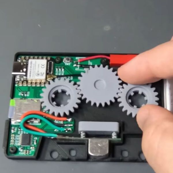

In the cross-over between the era of tapes into that of MP3s, you’d see quite a few of those special cassette tapes that were actually digital music players inside. Some simply provided a 3.5 mm input, while others were complete MP3 players or Bluetooth receivers that just happened to also output to the magnetic read head of a cassette player. Recently [Jonathan Rowny] decided to make his own version of the latter.
Although getting the actual audio signal into the read head is easy enough – requiring little more than its equivalent being used as a write head on the cassette side – actually interfacing with the player’s mechanisms like auto-stop, reverse and so on requires the use of some gearing that detect motion on what would be the tape spools, as well as transfer the motion from the take-up spool to the other spool so that features like the auto-stop mechanism don’t get triggered.
A lot of inspiration here can be found in e.g. the videos made by [Clint] of [Lazy Game Reviews] who looked at a number of examples – including their internals – over the years, with various levels of functionality. For this particular implementation an ESP32-S3 module is used for the brains, along with a microSD card reader for music and a PCM5102 I2S audio codec to create the analog audio signal.
The gears were printed using an SLA printer and seem to work all right. Unfortunately he didn’t realize the importance of the capstan as the mechanism that actually transports the tape, so its motion was not measured as is done in the better cassette adapters. This will likely be corrected in a future iteration, however.

On an audio tape, there are 2 tracks … that are quite easy to follow. Only the tape moves, and the read / write head just needs to stand at the right place.
A VHS tape requires read heads to be mounted on a spinning drum, which should be a challenge for a home maker I think …
On a LTO8 there are more than 6000 tracks on a 13 mm wide tape. A tape head can read 32 tracks at once.
When reading, the tape moves at ~5m/s (18km/h or 11 mph).
All these brings lots of challenges, and engineers work hard to write tape following algorithms to ensure the drive’s head follows the track accurately at 5 m/s …
Moreover, with such thin tracks, engineers have to deal with tape expansion due to temperature and humidity. With the tape expanding, the 32 tracks of the read head are not all lined up with the tracks on the tape which requires another system to line up the read head with the tracks on the tape.
By design, tape drives head are made to wore against tapes. The idea is that you can repair a tape drive (by changing it’s head with a new one), but you cannot easily rebuild the data on a damaged tape. So the more expensive thing is the tape drive, not the tape itself.
At last … I think it would be a non sense to emulate a tape drive with all these challenges, when it would be easier to build the correct interface (Fibre Chanel, SAS, iSCSI …). And think about the price of a tape, which is ridiculous compared to other data storage (HDD, SSD, …)…

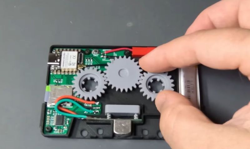

Ideally the gears could turn a little magnetic generator to charge up the battery.
That’s what I assumed the gears were for when I saw the image too!
Well, a capacitor rather than a battery. But yeah.
Unfortunately a quick chat with an LLM makes me think that we would be under the power threshold that an ESP32 would like. Might get like 200 mW of electricity before the tape player started to struggle with the resistance, which is low for an ESP32.
Maybe if the battery starts sagging you could have some mechanism that sleeps the ESP32 and tells the tape deck to continue “playing” to get some more juice in the battery before it tries to start sending data again
Fast Forward / Rewind, for more efficient charging.
A purpose built bluetooth audio chipset can stream audio into high-impedance speakers at ~100 mW, so it’s doable, although maybe not with the ESP32.

I think personally I’d have gone with an optical switch, none of the wearing parts associated with a physical encoder and, in the potential case of a hall switch, it eliminates having a moving magnetic field near the read head.
I’m pretty sure I saw something similar a few years back as a retail product.
I wonder if the guts of a wireless earphone could be repurposed as a more or less drop in replacement for this that would fit in an off the shelf cassette tape adaptor without having to 3d print anything or manufacturer a custom pcb.
using a as5047 with a 3mm diameter at the distance seen here would definitely require mumetal shielding given the small size/mass it would only require 4-8mils thickness

For those who wonder about the gear system in those cassette adapters, it is to make the tape player believe that there is actually tape moving. Some players detect non movement of the reels and stop playback. It depend on what cassette player you have whether you can get away with leaving these out, mostly auto reverse systems require such a setup but in those cases you most likely need a 4 track head too.
