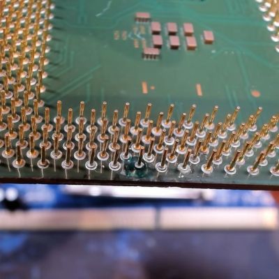

Before moving to land grid array (LGA) packaging whereby each pin on the substrate is just a copper pad, processors commonly used pin grid array (PGA) packaging, including the still highly relevant AMD AM4 socket. With PGA you get a pin soldered onto the copper pad which inserts into the ZIF socket, rather than a fragile pin on the mainboard side. Repairing a damaged PGA pin can be easy if just the pin broke off at the solder joint, or rough if the pad was destroyed, as in the case of this Pentium III CPU that [Bits und Bolts] recently tried to fix.

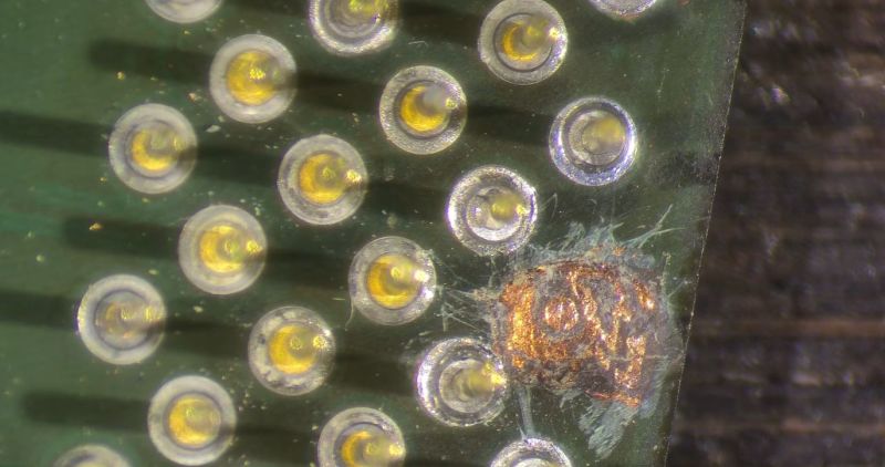

In the case of something like a ground pin or similarly unimportant pin you can ignore the damage, but in this case it concerned an important pin for this 1.2 GHz Tualatin PIII core, with the damage consisting of a well and truly destroyed pad. The first step to repair the damage is thus to try and rebuild the pad, which was done using solder mask and solder.
Although a PIII-era Celeron CPU is definitely not a high-value CPU, since they have so few and such large pins they do make for useful test subjects when it comes to PGA repair practicing. In this case the affected data pad and pin appears to have been repaired successfully, with it running overclocked to 1.6 GHz and crushing similarly or higher clocked Pentium 4 and AMD Athlon CPUs of the era.

I had once Tualatin Celeron 1-1.4Ghz (can’t remember exactly – it was 25 years ago, sorry) which are delidded (doesn’t give me any overclock advantage, it was already close to the edge of that generation) and had one pin broken off completely with a pad.
Unfortunately, it was functional pin, however, can’t remember which one.
So, I traced down that pad (thankfully it doesn’t go somewhere underneath but was trace on surface), scratch down that trace, solder in thin wire and solder that poor pin to that wire. Apply a little super glue over afterwards because pull off that super thin trace or soldering was very easy.
All that was possible then because it was one of the inner pins, closest to the center, so wire doesn’t need to run around other pins. :-)
So, afterwards CPU installation procedure was as follows:
Put down that single wired pin into the socket, carefully, in right hole (marker helps :-) )
Carefully put CPU next over it, carefully not to pull that poor pin.
It works at least year or two while in my possession and God knows how much more when I sell it for router server usage back then (complete motherboard/CPU combo, not CPU alone obviously, quite cheaply, and customer doesn’t care about all that pins ordeal – it will be install and forget Linux machine).
