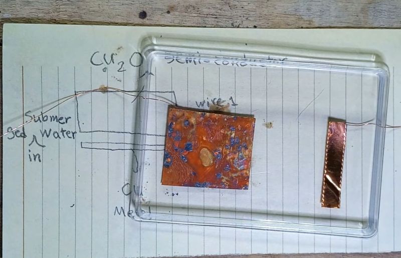

Photodetectors come in a wide variety of constructions and materials, with the Cu2O-based photodetector that [Mad Scientist Creations] demonstrates in a recent video being a good example of a photodetector that can be created at home using nothing but some copper and a heat source.
Of the two copper elements in a salt water cell, one element is heated to the point where a copper oxide layer forms, specifically Cu2O, which acts as a semiconductor and provides the photosensitive layer. Even a fairly crude sensor created with a regular gas stove produces enough of a current that it can be used in a simple light detection circuit.
