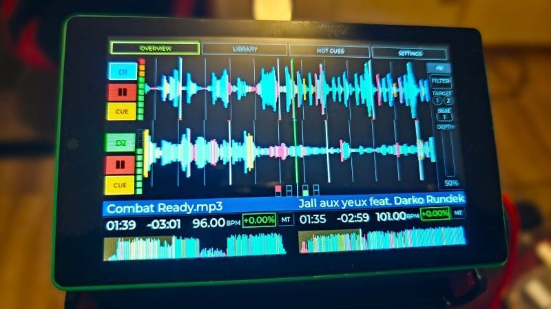

There are plenty of ways to DJ with a laptop and various controller setups. However, if you find hauling around an entire computer can be a bit much, you might like this lighter system from [Daniel Vučinović].

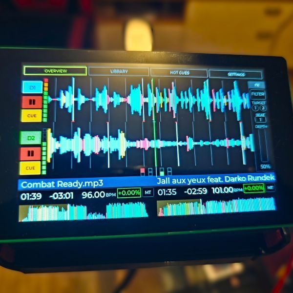

It’s called Pajoniiir, and it’s intended to replace a laptop in the DJ booth. In its place stands an ESP32-P4 microcontroller, hooked up to a 4.3-inch touchscreen display in an off-the-shelf combo from Guition. The ESP32’s twin USB interfaces are hooked up in turn to a Pioneer DDJ-FLX4 controller, and a USB stick carrying a Rekordbox music library. The microcontroller is then also hooked up to a PCM5102A DAC module for audio output.
The ESP32 reads and plays tracks in MP3, WAV, and FLAC formats, responds to commands from the DJ controller, and displays the waveforms and other controls on the touchscreen. It’s doing most of what a laptop would do in this case, only it costs $50 and won’t get stuck in a bootloop for a Windows update 10 minutes before you’re due to go on.

  1. Dyammmn, went over to the repo with my skeptic’s-hat on expecting to find no key-shift features, and i was happily proven wrong! This looks like a seriously impressive addition to diy electronic musicians’ toolkits, assuming the system’s robust and performant enough to let me walk into a gig confident there’ll be no dropouts or glitches. Thanks for the heads-up, I’ll be pouring through this codebase ASAP!
    1. Thanks. For every prerelease and release I have more then 10 hours soak test that runs every combination in mixing. Challenge was to solve high processing with deck1 and deck2 combination of formats…FLAC was pain in the…you know where :D So i needed to make compromise…max size of FLAC track is 50Mb. Cant do more…we must remember that device runs on ESP32

        1. Yes, because its not intended to be profesional equipment. Idea is to make working device so affordable that you wont get mad when you spill bear on beach party.

  5. Cool project! The FLX4 already is a USB audio interface though. I’d rather use that to output audio.

  6. Great project. You say rekordbox and FLX4. I figure any controller should be supported. I have a DDJ-400. Also re rekordbox. Is this the new OneLibrary format because I’m on Djay Pro AI
    1. No. Ddj 400 is also supported. There is guy who forked my repo and he doing port for ddj400. But till end of year most od pioneer, traktor, hercules controllers will be included
