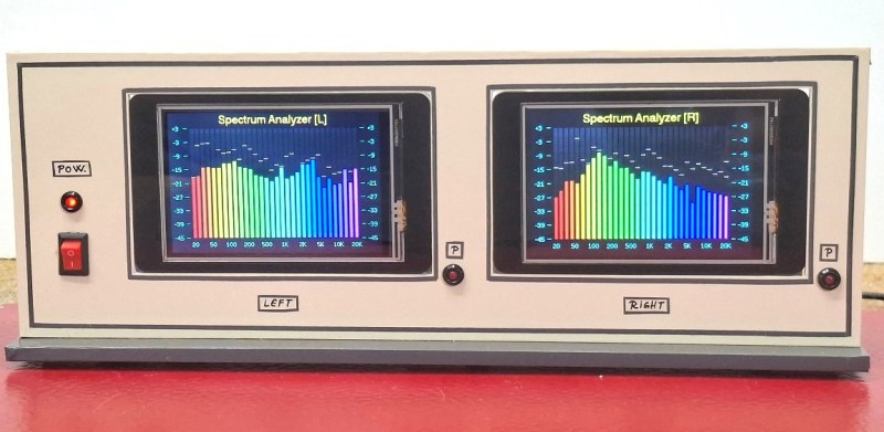

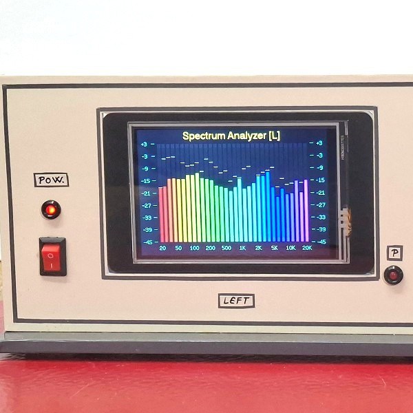

A slick spectrum analyzer used to be the kind of thing that would have been tricky to include in a DIY project, but as [Mirko “mircemk” Pavleski] demonstrates, a modern microcontroller like the ESP32 can handle the task with nothing more than a display panel and a few passives.
This particular example is built around the CrowPanel 3.5, which combines the powerful microcontroller with a 480×320 touch screen LCD. But there’s nothing inherently special about the CrowPanel, and you could get similar results with whatever display you might have kicking around the parts bin — albeit potentially with some code changes to account for the different hardware.

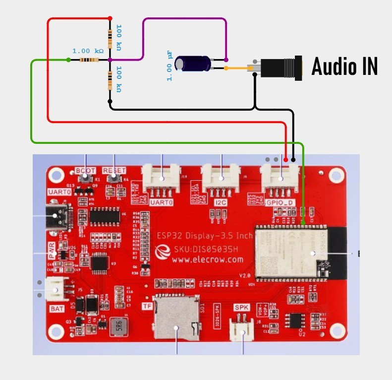

Beyond the microcontroller and the display, all you need to recreate what [mircemk] has done here is a handful of passives to tame the incoming analog audio signal so it can be piped into one of the analog-to-digital converter (ADC) pins on the MCU.

    I do have a question: based on your schematic, I cannot make out how you sample the L and R signals separately. It looks like you are just sampling separate polarities from one channel.
    Thanks!
    1. Based on the Hackaday.io link, I think that each display only has one channel attached to it (L or R). So two displays per enclosure, each one driven by a separate channel.
