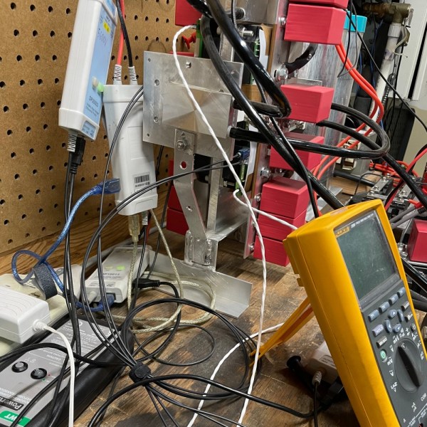

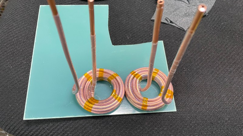

He’s got plans for the coils that go next to your head — made of hollow copper pipe to carry coolant, just like the pros do it — and the power supply to pulse them with mind-altering amounts of electricity. That might be literal in this case, but it’s also a hefty power supply: a pair of microwave oven transformers, switched through IGBTs in a flyback configuration. We’re talking kiloamps here, so make sure you know what you’re about before you try putting that kind of power right next to your skull.
[Zach] did, and he’s still here. Though to be fair, we’re not sure if he’s a very good engineer or just very lucky. Given he’s isolated the IGBT gate controls with fiber optics, and seems to follow other best practices, we’re going to guess the former, but it might still be both.
