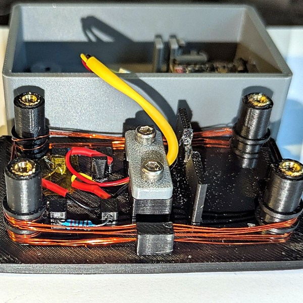

As the legacy AM broadcast bands fade away, what happens to the millions of devices built to receive them? Many of them will go into e-waste, but with a century of radios to choose from, some of them are collector’s items. Vintage tube radios like the ones [GarethDaviesLondon] has would go silent, so he’s made a small AM transmitter to keep them alive.

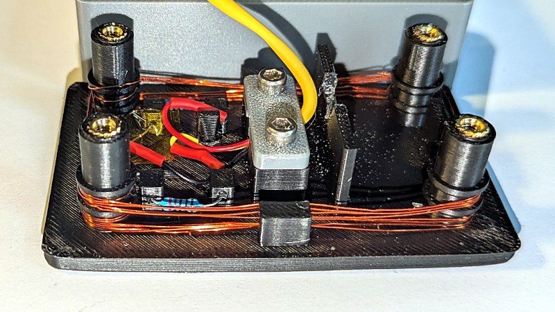

At its heart is an ESP32-S3, which takes an online radio stream and transmits it through RF generated with a pulse chain on a GPIO. Generating analogue signals from radio to video with a microcontroller is nothing new, but perhaps the more interesting part of this one comes in how he radiates enough from that pin. There’s a 3D printed box with stand-offs designed to take a widely spaced wire coil, which is enough for the vintage electronics to pick up. He makes the point that it may not be legal, but at that power we doubt anyone will notice.
The output on this one is 200kHz for the European long wave band, but we’re guessing a higher medium wave frequency could also be generated. Meanwhile if you are curious about AM, we’ve featured someone having a closer look at it.

  7. The key features of this project for me (and it was an experiment that worked).
    1. It is entirely realised in software.
    2. A single ESP32-S3 provides interenet connection to the web radio stations, a control web interface (frequency selection, fading, AGC, internet radio selection), a Command Line Interface (if needed), and the separate modulation of 2 x carriers.
    3. It lets the radio be a radio—you can tune between the two stations
    4. It has a fading effect (selectable) so you can get the signal to fade to the noise if you want to.
    It’s a fun project.
    It might be questionable whether it should radiate, but most of any energy (and it’s really small) is within the trapped magnetic field. The travelling field—at, say, 250 m far-field range—would be well beneath the noise level and undetectable (even the noise level of active devices on RX in a screened room, I’d expect, would be higher unless you cryogenically cool them). You can do the calculation: 5 turns at 15 cm length, driven by 3.3 V through 220 ohms. It’s femtowatts of ERP. And you can see that even the near field has a detectable range of about six inches on a tuned receiver. I don’t know the EMI levels for legal emissions, but I suspect it falls below limits. For instance, if you power it from a noisy PSU, you probably won’t be able to detect the signal in the noise beyond about 1cm from the unit.
    Now, of course, it is essentially an on-off PWM “square” wave, so you could use it to drive a gate driver and then a MOSFET and generate a few watts of power; then you’re definitely breaking the rules. If you were to do that, make sure you know what you’re doing and definitely filter that output. That’s a class-E amplifier—very efficient, apparently—especially at those frequencies, but I’ve not tried it. If you do, fire it into a dummy load, not an antenna.
