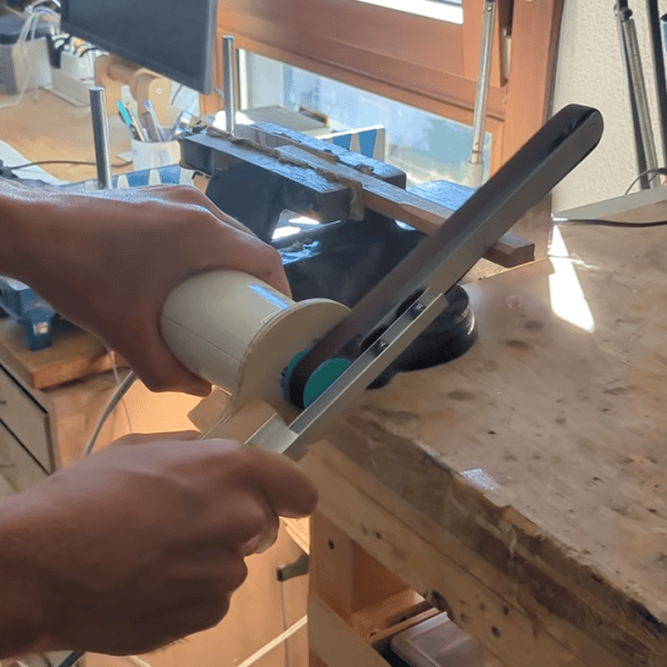

Making one’s own power tools can be a rewarding way to upcycle parts, and [bluesyann] does exactly that with a belt file made from an old mixer. We like how the enclosure for the old mixer is preserved and acts as a handle, so there’s no need to worry about motor mounting and wiring separately. It looks perfectly usable, and all the hardware needed is the sort of thing one finds in a scrap pile.

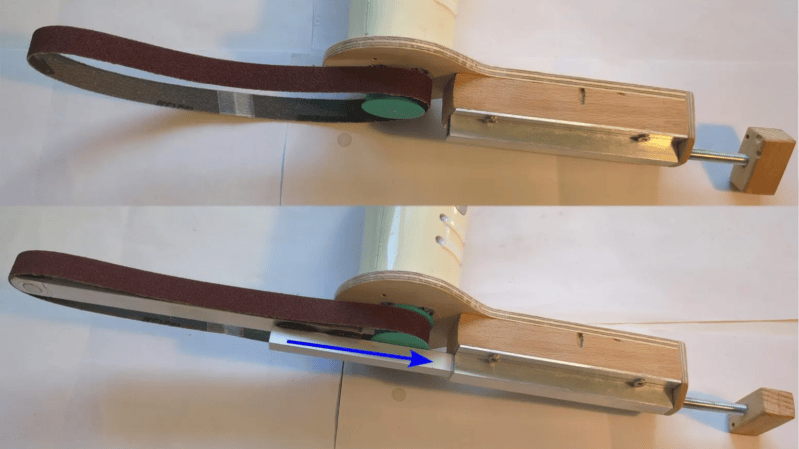

[bluesyann] stretches the sanding belt between a 3D printed pulley attached to the mixer motor, and a bearing fitted into the end of some aluminum U-channel. Scrap wood and more nested U-channel make up the rest of the assembly, and there’s even a tension adjustment made from a threaded rod.
There’s a bill of materials and a 3D model for the pulley, but a build like this is more about sharing the broad strokes rather than the exact design. Whenever one modifies or integrates an existing piece of equipment (the mixer, in this case) into a project, most of the work is about working with and around the bits one can’t change.
Watch it in action in a brief video, embedded just below. If you like the idea but don’t have a mixer like the one [bluesyann] used, let us point you toward a similar DIY attachment to get a similar result from a common angle grinder.
All the commercial belt sanders (except maybe for Temu offerings) use metal pulley. I wonder why is that 🤔

Wonder how long the plastic pulley lasts, though I’ve found my planer has one metal and one plastic pulley and seems fine.
I wonder how easily the sanding belt can slip out of the u-channel if you move it sideways across the material you are filing. Other than that I love this thing. Great idea!
Everyone needs to learn about crowned rollers.
The best of these are a joy for things like wood, fiberglass and car body work, but they have tracking control (as any belt sander should) and crowned rollers that are shaped to keep the belt on-center, as well as a padded metal shoe when the belt is pressed, all driven by a motor that has enough power for sustained use. Without these done reasonably well , it’s a short trip to the return counter or one bin or another.
