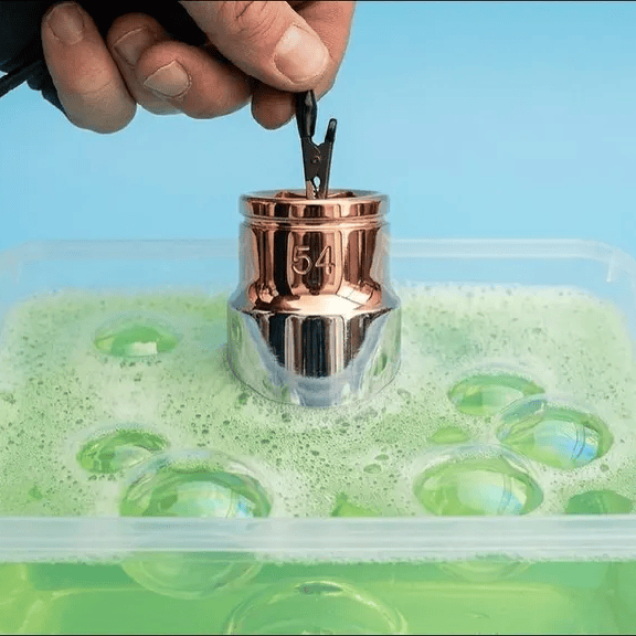

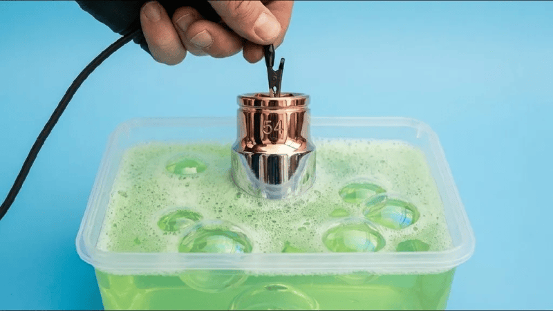

We imagine that electroplating is like making PC boards or soldering surface-mount chips. Before you’ve done it, it seems like a lot. Afterward, you can’t remember why it was such a big deal. [Kovancapol] wants to show you how to plate a mirror-finish nickel over your tools, and while it looks like a lot to set up, we are guessing that it gets easy once you have everything together.
There is a bit of chemical setup, as you might expect with reagents like nickel sulfate and nickel chloride. Then there’s the glassware, nickel anodes, and a power supply. As you can see in the video, the results look very nice. We can’t help but wonder what other uses you might have for this process.
A conductive coating on a 3D print might be feasible. We aren’t sure soldering PCB traces would be worth it since nickel gets hard to solder as it oxidizes. You can mix and match plating for some pretty impressive results.

Do I have to watch the video to find out what voltage PSU is being used?
No, because it isn’t about the voltage.
It is all about the current. 300mA.
You use a power supply with a current limiter set to 300mA and the voltage allowed up to 7V. The voltage changes to accomodate the 300mA. You don’t control the voltage at all.
Yeah lemme plate my car’s bumper at 300mA, should work just fine. You’re talking very confidently about things you know nothing about.

The video in the article talks about nickel plating. If you want to see actual shiny copper plating you need to watch the next video in the sequence:

“The Secret Of Mirrored Tool Nickel Plating” – This video shows exactly how not to do it. The most important thing is surface preparation and absolute cleanliness which the video failed in every way.
