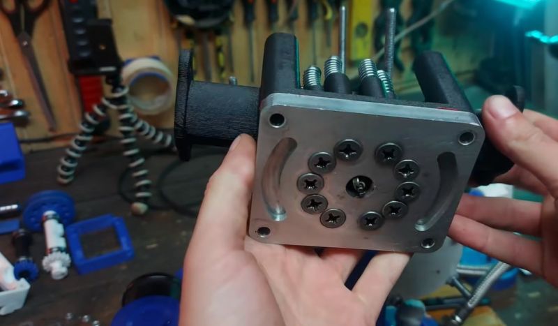

When it comes to internal combustion engines (ICEs), it’s generally accepted that each cylinder doesn’t have more valves to let in a fresh fuel mixture and to exhaust the aftermath than absolutely necessary. You could argue in favor of this also because it reduces the amount of valve seat surface and thus the potential for leaks, but there is historical precedent for higher valve counts. Hence [Alexander’s Laboratory] had to give a ten-valve engine a shake, just to see what effect adding more valves has.
A cited historical example is the Yamaha FX750, which features a four-cylinder engine that has three inlet and two outlet valves per cylinder, making for a 20-valve design that is claimed to improve performance, also because each valve can be smaller and lighter than with a single valve per side. Other motorbike manufacturers would also try such configurations, with some fascinating examples shown in the video.

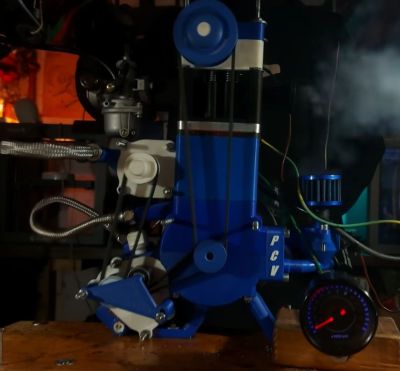

What [Alexander] tries here is to create a 10-valve version, for a symmetric five valves intake and five for exhaust. Rather than building an entire engine from scratch, the largely 3D-printed ICE that was featured in previous videos will be modified with a new cylinder head, replacing the current four-valve one.
For the custom valves large wood screws are used, after making sure that they can take the heat of the combustion. Making even ten of these small valves fit was a challenge, but ultimately got squeezed into a CNCed aluminium and nylon-printed hybrid cylinder head. The existing camshaft was reused by using an adapter that simply drives five valves at the same time.
After some troubleshooting and tuning the engine actually runs pretty well, though sadly no comparison metrics were provided versus the four-valve version of the cylinder head. Hopefully we’ll see this in an upcoming video.

I’d be interested to see how this compares not only to the 4 valve design this engine previously used, but an even simpler 2 valve design. Ideally you’d make the valves as large as possible in each configuration.
it’s been tested by the auto industry and 4 valves is the most efficient. 5 valves and up tends to restrict breathing.
My understanding is that for geometric reasons, 4 or 5 valves per cylinder are the ideal number and have roughly equivalent flow – it has to do with the combined area of how many smaller circles you can fit into a larger circle. With performance being a toss-up and mechanical simplicity favoring 4 valves per cylinder, that became the industry standard.
I guess it would be a lot harder to get a good seal, but I wonder if anyone has tried non-round valves?
many alternatives have been tried and worked at higher rpm but all had a short life, because the poppet valve sinks into its valve seat and rotates, it grinds itself a better seal during operation and has low mass.
it would be less of a technical challenge to change the piston shape to fit more valves, but then you end up with a design that is uneconomical to produce.
@Bob, Honda had the NR, a 32 valve “oval” piston V4
the air flow from each also starts to interfere with each other, the ideal is probably placing the intake/exhaust pairs diagonally, and it has been done, but add a lot of complication with the intake/exhaust manifold
One reason for more than 2 valves is that the valve circumference matters as much as area for gas flow – especially when partially open. Multiple valves for intake and exhaust help with this.
