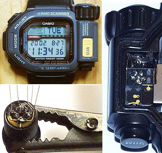

    BTW if you want to talk fine soldering: http://www.haku.co.uk/pics/CasioThermoscanner.jpg
    Broken miniature ribbon cable meant having to solder 5 individual strands of wire, and that was back when I had a crappy soldering iron.
    The watch & thermoscanner still works, but the strap disintegrated long ago.
