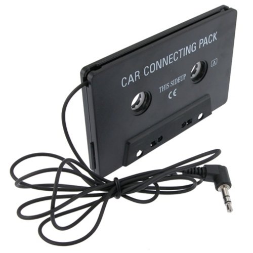

  4. Why not find a stock Jeep radio and simply mod the cassette section to use the Bluetooth? it would look a lot cleaner and be theft proof (as in nobody wants a stock cassette radio) and have a much better sound than that amplifier.
    Plus you have the option of FM radio in case you miss listening to 2 hours of commercials and 5 minutes of music.
