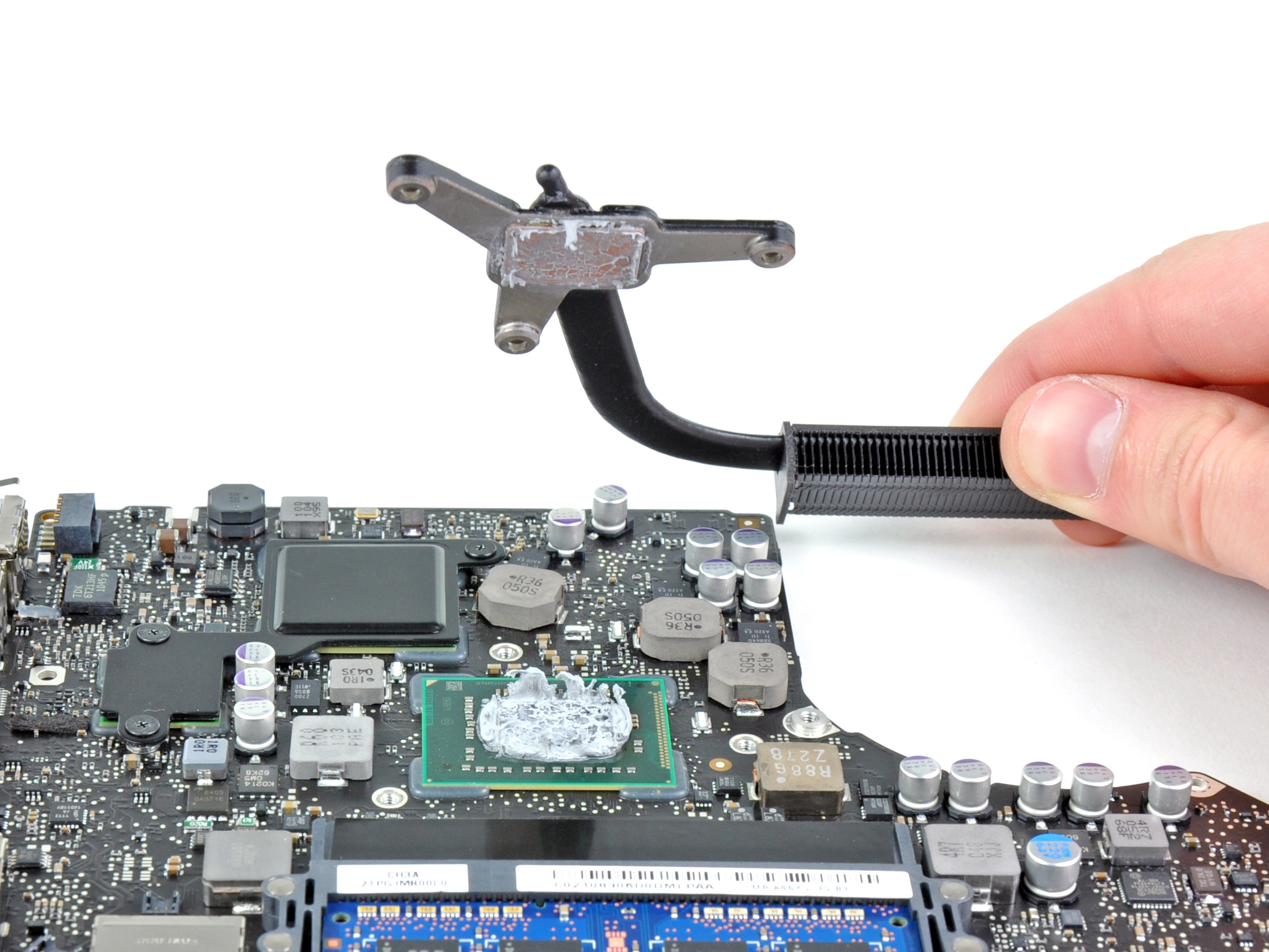

Sick of his 2011 Macbook kicking its fans into overdrive every time the temperatures started to climb, [Arthur] decided to go with the nuclear option and cut some ventilation holes into the bottom of the machine’s aluminum case. But it just so happens that he had the patience and proper tools for the job, and the final result looks good enough that you might wonder why Apple didn’t do this to begin with.
After disassembling the machine, [Arthur] used double-sided tape and a block of scrap wood to secure the Macbook’s case to the CNC, and cut out some very slick looking vents over where the internal CPU cooler sits. With the addition of some fine mesh he found on McMaster-Carr, foreign objects (and fingers) are prevented from getting into the Mac and messing up all that Cupertino engineering.
[Arthur] tells us that the internal temperature of his Macbook would hit as high as 102 °C (~215 °F) under load before his modification, which certainly doesn’t sound like something we’d want sitting in our laps. With the addition of his vents however, he’s now seeing an idle temperature of 45 °C to 60 °C, and a max of 82 °C.
In the end, [Arthur] is happy with the results of his modification, but he’d change a few things if he was to do it again. He’s somewhat concerned about the fact that the mesh he used for the grill isn’t non-conductive (he’s using shims of card stock internally to make sure it doesn’t touch anything inside), and he’d prefer the peace of mind of having used epoxy to secure it all together rather than super-glue. That said, it works and hasn’t fallen apart yet; basically the hallmarks of a successful hack.

Changing the airflow like this might improve CPU/GPU cooling but it could very well cause other components to overheat now that the air is drawn through the system in a completely different path than designed.

I have been monitoring HDD and battery temps, they have not increased.

Yeah, I can see his point and I think he should really redo the securing at least, because superglue? I’d not trust it and if it gets loose you have metal flying around inside the case..
Also if he goes through a CNC to get it nice why not also run the mesh through a cutter to fit in the holes instead of laying on top, although I’m not sure what the best/neatest way of securing it would be.
mill holes in the case, mill a mesh holder to fit said holes, spot weld the mesh into the holders, then press fit the holders into the holes.
or just use the CNC machine to drill a grid of fine holes, and skip the mesh.
or just clean the dust out of the thing, and scrape/replace the thermal compound on the CPU with some fresh, higher quality stuff, as works on most every other laptop that starts overheating in its old age.
Just mill a mesh, done. :)
I thought about advising spot welding, but there are a few issues, like the materials used, and the discoloring and/or deformation that might occur.
I would use a rubber-based adhesive. Unlike cyanoacrylate, they won’t shatter with shock.
Was not CNCed, milled out manually. considered inlaying the mesh but the thickness/ strength of the bottom panel would have been considerably weakened. Planning on re fixing the mesh to the case with epoxy next time I am in the mood.

I own a MBA 11″ with an i7 and several core 2 MacBooks and I’ve discovered that continuous thermal throttling is just Apple’s design preference. Your hardware temps will hang out in the red zone while full CPU is only briefly available. Turning off Intel’s turbo boost and overriding the stock fan speeds has been a game-changer for me. Check out “smcFamControl” and “Turbo Boost Switcher” for quick solutions. This should lengthen the life of the hardware and use of the battery. Also grab the “Intel Power Gadget” to see a nice graph of clock speed and power consumption.
