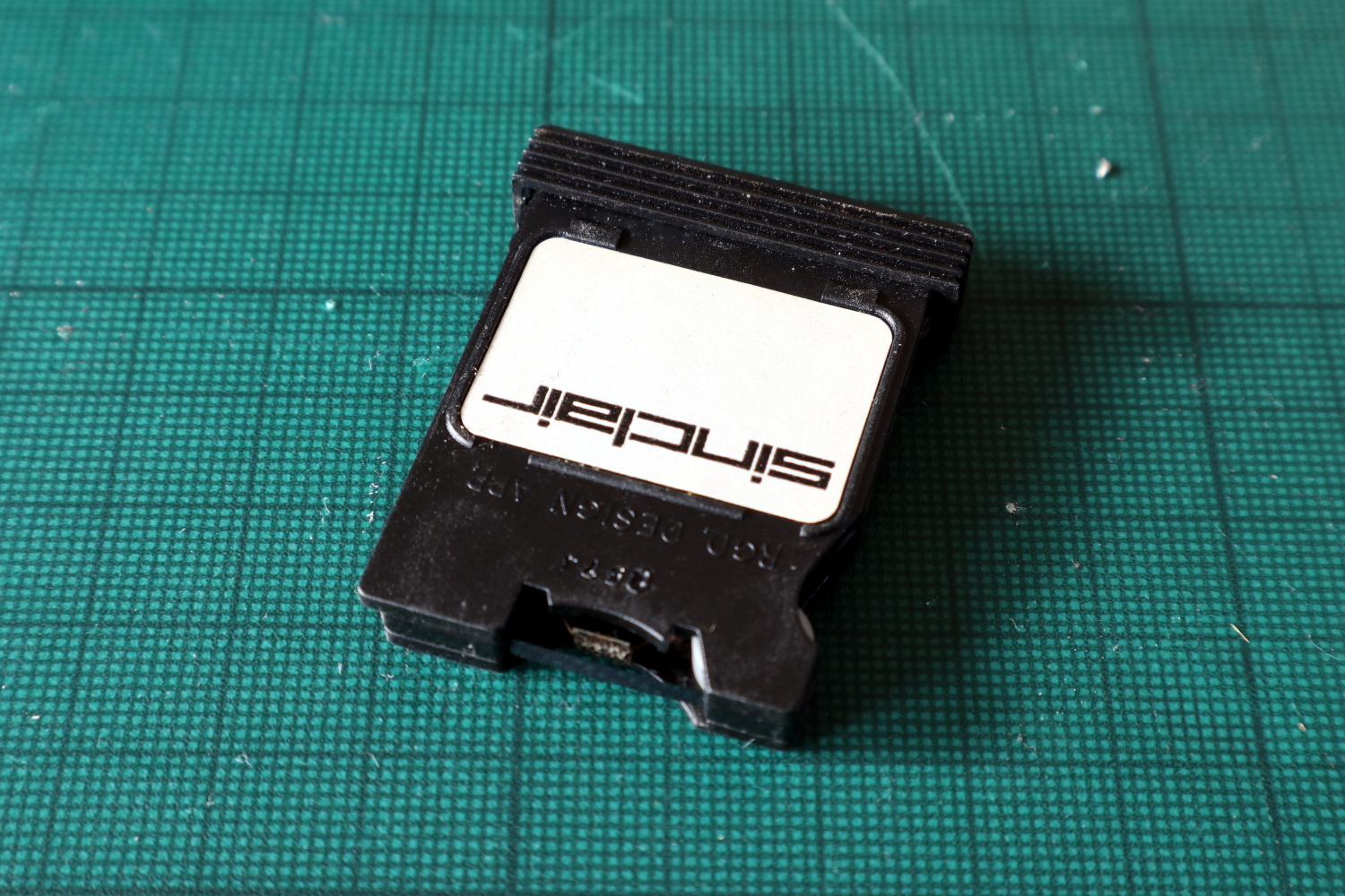

The cartridges are 43 mm by 7 mm by 30 mm, containing 5 metres of 1.9 mm self-lubricating magnetic tape in a continuous loop. I don’t blame Clare for not letting me lever open one of her vintage cartridges, but thankfully Wikipedia supplies us with a picture of a cartridge with the top off. Immediately the resemblance to the 8-track cartridges becomes apparent, the capstan roller may be to one side but the same loop of tape feeds back into the center of the single reel.
The ZX microdrive manual optimistically claims that each cartridge could hold 100 kB of data, but the reality was that they held about 85 kB rising to over 90 kB once they had stretched a little with some use. It’s fair to say that they weren’t the most reliable of media, with the tape eventually stretching to the point at which it could no longer be read and even the Sinclair manual advising backups of frequently used tapes.

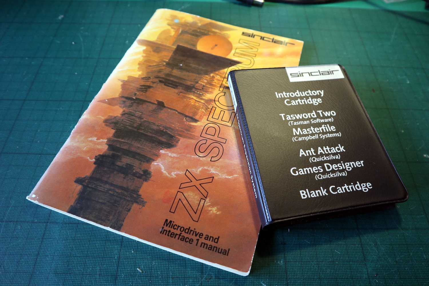

A last word in this teardown should go to the manual, a characteristically well-written slim volume which gives an insight into the system and how it integrated into the BASIC interpreter. The networking ability is particularly fascinating as it was rare to see it in use, it relied on each Spectrum in the network issuing a command to assign itself a number upon start-up because there was no Flash or similar memory onboard. This would have been incorporated to target the schools market as a competitor to Acorn’s Econet, it’s not surprising to see why the BBC Micro won the Government supported schools contract instead of the Sinclair machine.
