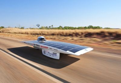

The Tokai Challenger, built by students from Japan Tokai University, won the 2009 event. Note the extreme, streamlined design aiming to minimise drag.
Much like traditional motorsports, the regulations of the World Solar Challenge have shaped the designs of competition vehicles. With limited energy available, efficiency is key in every aspect of design. A competitor that is able to capture the most energy and turn it into forward motion is best placed to bring home the win.
On the electrical side, the first concern is effectively capturing as much energy from the available sunlight as possible. Installing the highest-efficiency solar panels available is just one part of the equation. Teams will often tilt their solar panels to be perpendicular to the sun’s rays after driving ends at 5:00 PM, to make the most of the light available before sundown. To wring every last drop out of the cells, Maximum Power Point Tracking hardware is used to keep the solar cells in their optimum operating range. Motors and controllers are similarly designed with a focus on wasting as little power as possible when propelling the vehicle down the road.

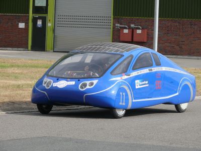

2013 saw the introduction of the Cruiser class, for solar vehicles intended to carry multiple passengers.
Perhaps the biggest impact on the external design of these vehicles is aerodynamics. Travelling at speeds of up to 130 km/h for hours at a time, drag plays a huge role in terms of energy efficiency. Reducing drag to the absolute minimum is key, with vehicles in the single-occupant Challenge class often featuring swooping, knife-blade teardrop designs. Wheels are often fitted with airfoil-shaped fairings to allow them to slice through the air. Historically, most designs had drivers laying in near-prone or recumbent positions to minimise their contribution to the profile of the car, however in recent years, seating positions have been changed to a more natural upright position to better resemble a road-going vehicle. Entries in the Cruiser class tend to have more compromised designs in this area, as they are necessarily bulkier and taller in order to carry multiple seated passengers. However, they still aim to minimise drag wherever possible, even if knife-edge streamlined designs aren’t practical in this class.
Mechanical efficiency is also key in order to build a competitive vehicle. Rolling resistance must be kept to a minimum, and specially designed tyres are used in pursuit of this goal. It’s also important to ensure bearings, chains and belts are properly chosen and maintained to avoid excessive losses in these areas. Attention to such small details can have a serious impact when travelling thousands of miles, particularly when such low amounts of energy are available.

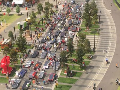

  5. Darwin to Adelaide’s Victoria Square? I guess McLaren (sp?) Vale got tired of being invaded every year. In the 1990 WSC, there were vehicles managing 45-60mph, running for 8 hrs a day, and drawing 50% of the power required directly of their arrays.
