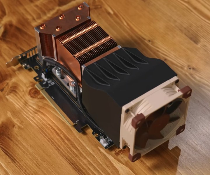

He’s gotten a hold of a 16 GB NVidia V100 card for only about a hundred bucks, mostly because it’s not easy to plug in, being on an SXM2 socket rather than the PCIe bus. SXM is a server architecture, and not something you’re likely to get on your motherboard. Another hundred got him an adapter board to fit this enterprise GPU on a consumer motherboard. That’s still a lot less than the PCIe version of the same card, which will likely set you back a thousand or more unless you get very lucky on eBay.
It’s not the newest card, dating back from 2017, but that doesn’t mean it can’t run the latest open models. After 3D printing a fan shroud for the thing so it didn’t cook itself, adding very slightly to the build cost, [Hardware Haven] set to work seeing what it could do. Going head-to-head against an RTX 3060 12 GB, the older V100 delivered more tokens per second at a  slightly higher efficiency — but much higher idle power.

  1. There are a bunch of these cards IN PCIE FORM FACTOR right now on eBay for less than they said. ($350 buy now, $90 OBO, etc.) This is specifically an exercise in adapting SXM to PCIe.
    1. This wasn’t the case until recently. Adapting SXM2 has been the cheaper route over the last few years, especially for the 32GB version. It seems like this may be changing now that these cards are aging further and no longer supported by the latest CUDA.
      IIRC, the SXM2 versions of the V100 have slightly different specs than the PCIe versions – higher clock speeds but slightly less memory bandwidth. So the PCIe version may actually be a little bit better for LLM inference.
      To further confuse things, these days I also see a lot of SXM2 modules being sold on eBay with a pci-e adapter pre-installed, and not always advertised as such.
    2. Sxm2 v100 + adapter can be done sub-$200 with fan, cheapest legit v100 pcie for sale is $300 and you’ll need a fan to cool beyond that. Dunno where you’re seeing $90 for a pcie v100

      2. Given an rtx 3060 goes for max 250, it’s much better to get one of those and enjoy recent CUDA support. It was interesting for the 32 gb version before prices rocketed. Rtx 3060 is still one of the most cost effective cards to run llms on, 1 or multiple

      I got a 16GB V100 and an adapter card in 2025 for a combined total of ~100.
      It’s sitting in my proxmox server, limited to 100W, split into 2x 8GB vGPU instances, and each is 3d accelerating a remote desktop.
      It was way cheaper to set up a remote gaming server for my nieces this way rather than buying discreet GPUs and jamming them into the little 1 liter ex-corpo desktops I built for them 3 years ago.
      They run Minecraft just fine.
