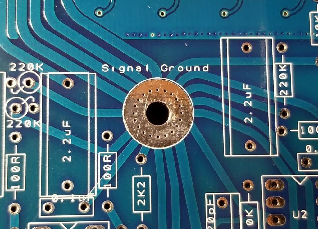

Ideal ground in electronic must be in 1 point. You even saw it in old tube type audio. Also in some cars.
1st time I read it in my dad’s book from 1965. Then I learned more about the groud point when I got my fisrt oscilloscope.
I cannot insert a pictire, but here is the link: https://res.cloudinary.com/rs-designspark-live/image/upload/c_limit,w_1024/f_auto/v1/article/picture_5A1_c52f97b3324492988747ae09229345d666a52d29
Single-point (aka “star-ground”) is in most cases the approach. And in demanding situations, it’s not trivial to deal with a mix of devices.
https://www.ranecommercial.com/legacy/note151.html
It’s an often misunderstood subject. I’ve found Robert Feranecs videos on the subject to be very enlightening. Even though it’s about PCBs, the general concepts also apply to wiring:
