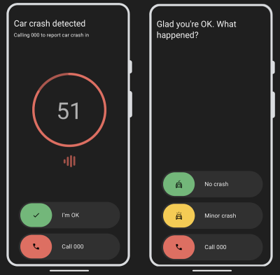

Can You Sense Something?
Smartphones are so much more than just telecommunications devices or pocket computers these days. They’re sophisticated sensor packages that we carry with us wherever we go. Top-tier models now pack in everything from advanced navigation chipsets to satellite communications hardware and even 3D scanners.
Across the board, though, virtually all modern smartphones feature some kind of accelerometer inside. The most obvious use for this device is to detect the orientation of the phone relative to gravity, in order to rotate the display to suit portrait or landscape mode as needed. They’re also commonly used for controlling games or as the basis for those popular lightsaber and “digital beer” apps of a decade ago. These sensors have become more sophisticated over time, and modern phones often feature three-axis accelerometers along with gyroscopes and even magnetometers inside.
Apple has now decided to leverage the iPhone’s suite of sensors for a more noble purpose, detecting if the user has been in an automobile accident. It follows on from Google’s Pixel line of hardware that has had a similar feature for several years now. The accelerometers can be used to determine if the user has been subjected to high acceleration, such as when hitting another car and coming to a sudden stop. Similarly, the GPS can provide data on sudden speed changes, too. Additionally, the microphones can be used to detect loud noises such as shattering glass if the phone is aware it’s in a driving situation. The phone’s on-board barometer can even detect a pressure spike of airbags going off in a car with the window’s closed.
But they also try to figure out if you’re in a car in the first place. They claim to be monitoring whether it sounds like you’re in a car, passing WiFi stations, and bound to a car’s Bluetooth.
When a crash is detected, the phones typically sound an alarm and display a prompt telling the user a crash has been detected. If the user doesn’t cancel the prompt after a short period of time, the phone automatically dials emergency services and can even notify contacts that the user has been in an accident.
The Real World
Overall, there’s a whole suite of features that can work together to detect accidents. However, as testing by the Wall Street Journal showed, the crash detection features in modern smartphones come with some caveats. In a series of test crashes executed in a junkyard environment, both iPhones and Pixel phones failed to trigger alerts. The problem was that without being paired to a car’s Bluetooth device, and without the GPS indicating the user was on a public road, the phones didn’t always register that they were in a driving environment. Thus, they weren’t in a mode where the crash detection system was enabled.
It’s obviously not great if a phone fails to detect a major crash. However, these features are new, and few of us are relying on them as critical safety devices. Even if they only work to detect some crashes, they’re still delivering a net good.
However, there’s also a problem with false positives, where a crash is detected where none has occurred. One iPhone owner reported his iPhone flying off the handlebars of his motorcycle on the highway. The rider was fine; it was just that the phone had detached itself from the bike. Unfortunately, this apparently triggered the phone’s crash detection system, which notified several contacts that the owner had been in a serious accident. Upon sourcing a replacement phone, the owner was greeted by panicked voicemails from family thinking he was severely injured.

Dumb question: but, shouldn’t the phone start making a loud noise to alert the driver of the potential automatic emergency call? Like, if I’ve been in a fender bender, there’s still a good chance the phone bounced somewhere unknown/unreachable if it wasn’t in my pocket. Then the auto call shouldn’t cause too much issue as long as the phone isn’t too hasty about making the emergency call (time is of the essence, but, too many false positives will negate it’s whole purpose), if someone’s phone is screeching when they get off the ride, they’ll probably look at it to turn the noise off.
Is there possibly a way to integrate with emergency services in a way that it can contact them quickly without wasting emergency resources. Something like prepping by sending GPS and basic identification information, but not dispatching anyone until it’s confirmed.
They could also identify if the areas are very crowded at the time it happens, as such, a human is likely to also report the accident, making the phones GPS valuable, but the phones report not.
There isn’t really any solution the false positives from a dropped phone unless it can tell when the crash is too dramatic (and likely from just the phone itself) but, that seems like a hard problem to solve without false negatives).
P.S. I mentioned in another comment that there are lots of things they can check to see if it was a false alarm, such as the user still moving around a lot or walking. And identifying locations where the system should be disabled or toned down even if it creates a tiny blindspot.
It does make a sound and gives you 20s to cancel but you’re on a roller coaster, you’re not gonna be checking your phone.
This sounds nice when viewed superficially, but it’s completely bonkers once you start thinking about it a bit more. It’s unlikely to be reliable enough to trust upon, and it’s likely to have lots of false positives, or at least be another battery drain. And how does that sound analysis work? Is that uploading sound to some mist service?
